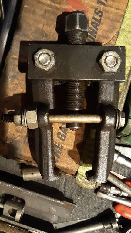

May 29, 2020 #22 '69FuryIIIConvertible Fixer of junk FCBO Gold Member Joined Oct 18, 2012 Messages 4,215 Reaction score 5,431 Location Newcastle, Ontario, Canada I have one of these.... Lisle 41970 It's beefy. Nick

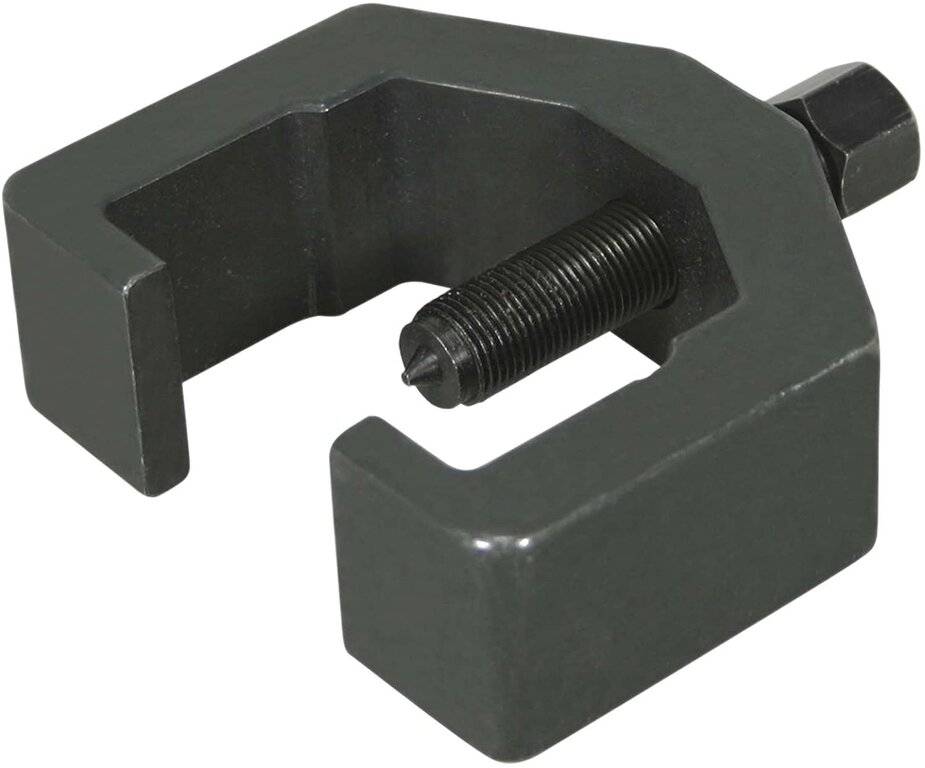

Jun 7, 2020 #23 C Cbodyuser New Member Joined Jan 18, 2012 Messages 6 Reaction score 1 For a heavy duty pitman arm puller for a C body, get a Snap On CJ119B or a OTC 8150 or equivalent.
