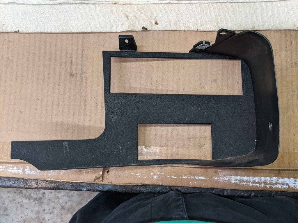

I have the 1973 Dodge radio and air conditioning trim panel pictured below. It’s in good condition, except for the crack also pictured below. I have some JB Weld Plastic Weld that I was considering using to make the repair. I have read of people using fabric behind repair. 2 questions
· What kind of fabric is used in plastic repair?
· Is JB Weld a good adhesive for this repair or should I use something else?
Thanks for your help!

The plastic cracks as the oils in it evaporate with time, which can also result in some shrinkage and cracks/breaks. The "fabric" is used to reinforce the plastic used for the repair. Just like in fiberglass repairs, you place "the mat" and then soak it in plastic (which is then worked to make the repair invisible, just as with sheet metal).
Rather than a hard JBWeld-type product, perhaps something like the clear resin (UV light-cured) that another member used to repair his windshield washer reservoir (posted in here a month or so ago)? Use the plastic to put everything back together, then the fabric for reinforcement, then re-install gently?
There are SOME OEM plastics which superglue will NOT stick too, from my experiences. Too much "oil" in the plastic formulation? As others have used a baking soda dust of the pieces before they used superglue, too. Whatever works . . .
Just some thoughts,
CBODY67
I prefer the two part adhesives that are specifically made for plastic. You can find them at just about any auto parts store in the same area as the epoxy's, in the same type of double tube dispenser. One brand is something like "plastic welder".
Another method that usually works fairly well is to use a soldering iron to melt the plastic back together.
Jeff
I often use a soldering iron like Jeff mentioned, but your only going to want to use it on the back of that panel as to retain the texture on the front. It depends on the type of plastic on how well it works though.
That dash piece will take any number of glues and epoxy. The issue is if you try some thick stuff between the crack you may get it to work but you will still have a glue line. If you dig that off you will mess with the texture. For me I've used super glue, the thicker stuff is better, and it will bond and give you a nice front look. Almost unnoticeable. But super glue is not very super on anything that get torque or twisting. So you have reinforce the back. Mostly I use metal window screen. Before you do rough up the plastic with course grit sandpaper. Cut an L out of the screen for that corner and use something like epoxy, regular or plastic bonding, or more superglue and baking soda. Its my new go-to. Very strong and quick. Epoxies work well too. For that corner I would double the L layer once the first is dry. I have a crack in backup dash bezel like yours and that's how I'm going to do it. Superglue plus more superglue and baking soda. Have fun
I don't know how it looks on the back, but if possible I would fabricate some kind of small square (plastic cut out of anything you could find) and glue that on the backside..
