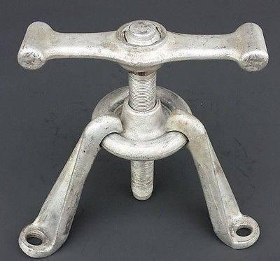

Okay yes, what happens is the puller is used to put tension on the hub by making it tight using a ratchet, then once it is tight you use a mallet to hit the end of the puller to make it pop off. It makes a loud bang when it does. What sort of puller are you using? it should have three legs and goes to the studs to be bolted on, not to the edge of the flange.
Yes, that is the only correct tool that works and that should be used.

But try and find one...
