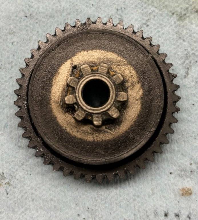

anybody know where I can find that power window drive gear Chrysler 300 1966

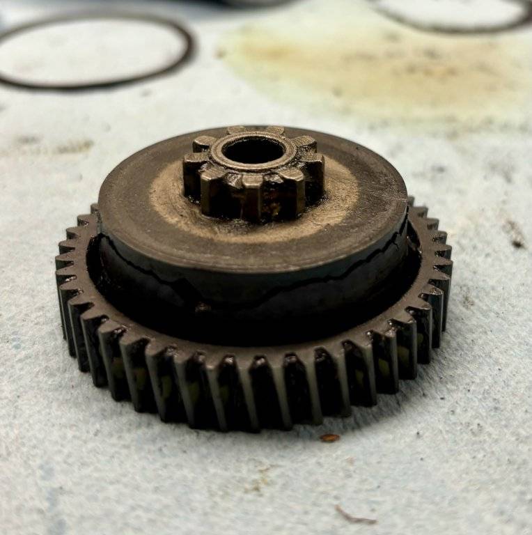

I've been looking at the power window motors for my 1965 300L. The '66 uses the same part number, so I believe it's the same motor.
First, and before anyone chimes in about buying a new one, or replacing the rollers with nuts, they aren't the same as later motors. What year they changed, I haven't figured out yet. The center of that drive looks to be a solid piece of rubber, rather than the later drives with springs or rollers. While the diameter is the same, the worm gear is different in the drive and the later gear will not work.
Here's a pic of the worm gears just to show what I've talking about. 1965 gear is at the top.

Now that I’ve clean all the parts most of it is gonna be great, but I’m still gonna be looking for two gaskets and that gear

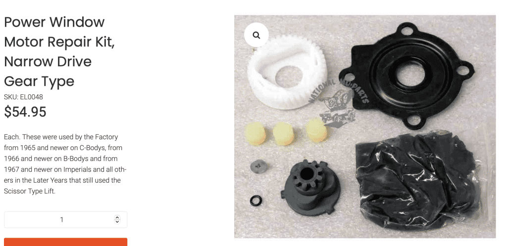

so this one would not work ?
I'd say a hard no on that.
It will actually fit into place (I tried one) but the worm gear is different and I'm sure it won't work.
I don't have a good picture, but it comes down to the angle of the teeth on the big gear has to mesh with the angle of the worm gear or it will bind. The green gear is the older style and you can just see the teeth are shaped a bit different. It all gets into worm gear angles and all that stuff that is a science unto itself.
I should add, the small gear, that actually mesh with the regulator gears, are the same.
BTW, that gear you posted is overpriced and it would be cheaper to buy that entire motor I posted from eBay.

it may sound crazy maybe I can try to repair the gear I have whit like PL glue or something what tike that. just crazy ?
