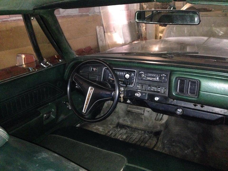

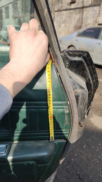

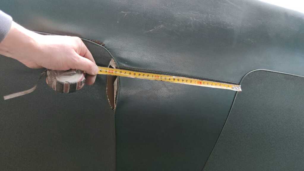

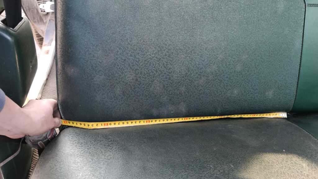

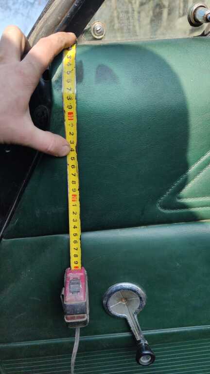

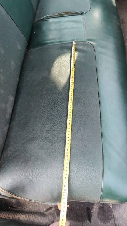

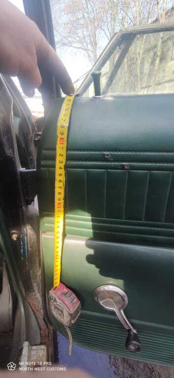

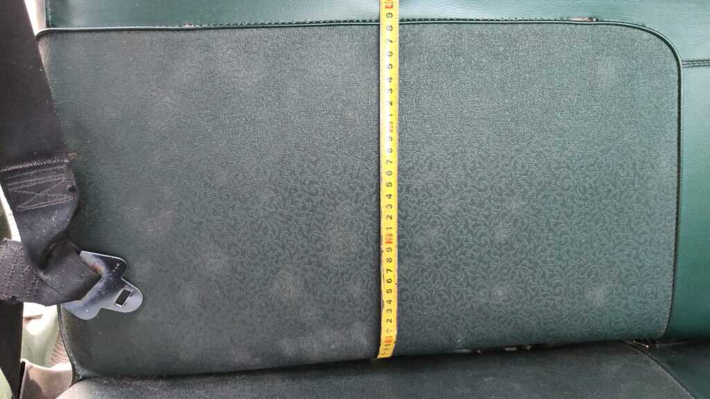

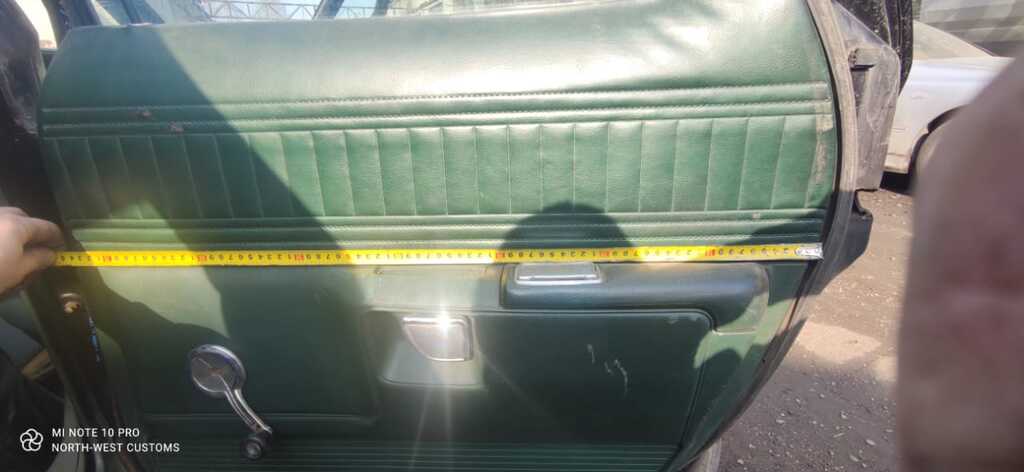

Due to the fact that I am in the process of complete refreshment of the interior and since I was not able to find HQ photos of the Fury I's interior, I asked my colleague to take measurements from the seats and door panels of another local car. I would like to share the visual result here. Maybe it could help somebody to solve the same issue with the interior that I currently have.
The photos do not claim to be super accurate, but they can provide a person with the general idea of how the interior can be reshaped relatively close to the original.

Anyway below the spoiler there are all measurement photos in its limit of 20 pix. The mentioned above link also provide detailed look of the interior + some more photos.
It worked! Is that the interior of the black 1974 Fury I you once wrote about?
Is there anything known about its history, for instance, that it was once an embassy car?
Unfortunately, I have no information about the car except the fact that it was imported into the country during the Soviet era as well as my vehicle. Both cars are almost alike so maybe they were of special order party. I've got to check the vin of the black one to confirm this idea.

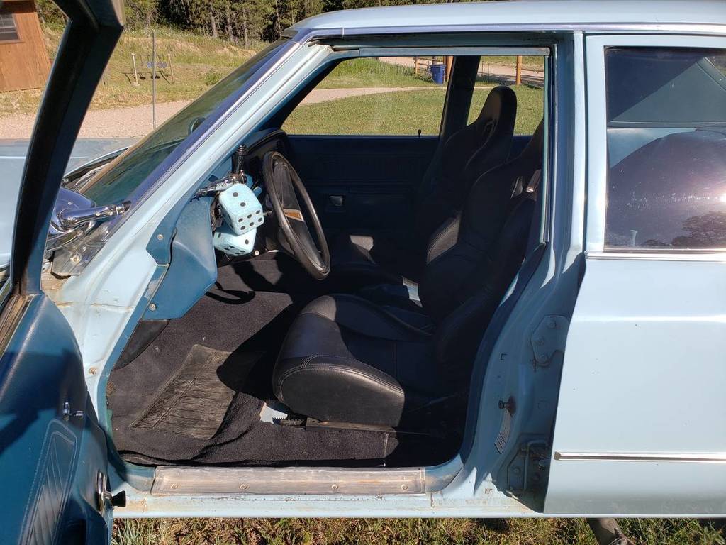

But pictures of other cars (the two I's in Russia, one II from Montana Highway Patrol) show the up-market steering wheel for Fury III, Gran, Custom Suburban and Sport, "not available on other models":
Three is a fair number, so I'd say the one with vertical insert was available on Fury I and II.

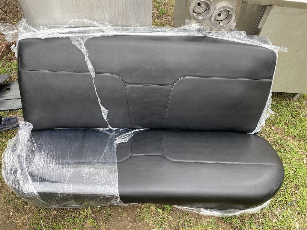

Having no original panels and seats we had to use only photos and official vehicle catalogue. We are aware that it is impossible to achieve the factory result, but at least the current progress with door panels and rear bench looks fine for summer daily driving.
