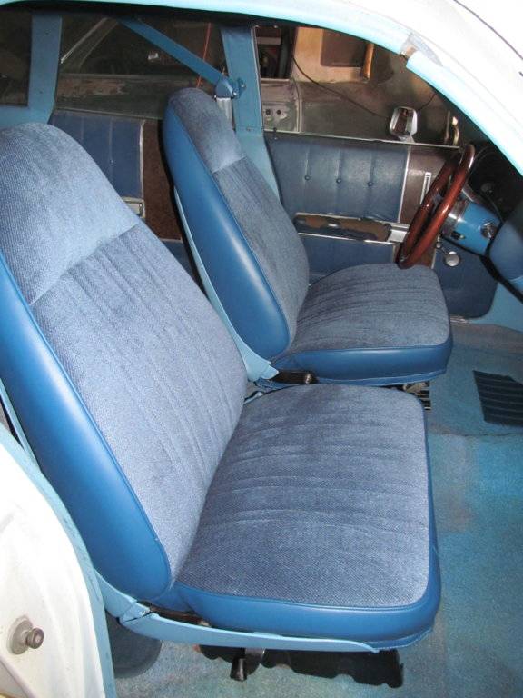

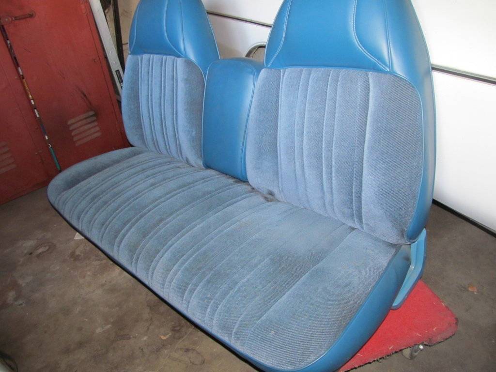

Did that conversion in my 73 Suburban. Removed the high-back bench seat and installed two buckets, the driver-side being powered. Looking at removing the original fold-down rear seat and putting the old front bench in the back.
