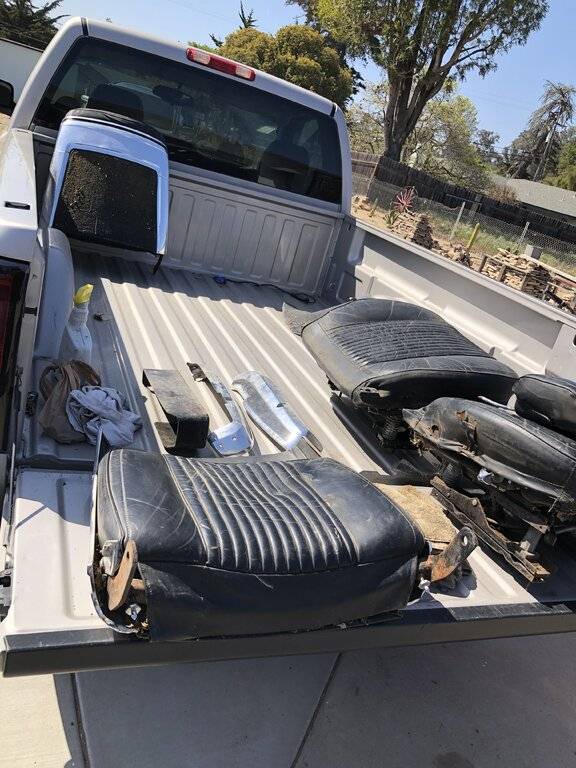

Hello all and thanks for stopping by to read my post. You may remember me who was looking for a set of ‘66 Chrysler 300 buckets in specific! Well, thanks to barnfind here on the forums I was able to score a nice set!!!
I was wondering if there’s any standard procedure for when it comes to cleaning up the powered seat bases on these seats. If I’m correct, ‘66-‘68 Chrysler seat bases are the same?

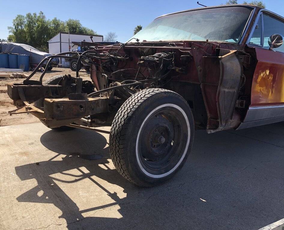

These seats are going into a ‘68 New Yorker as I’m customizing the car to my liking. Originally my New Yorker has a power drivers seat and a manual operated passenger seat. The set just got from the 300 has BOTH of these seats powered. Nice! Is there a way to draw power for the passenger seat? Kinda stumped but I know you all have experience and a wealth of knowledge!

The nice thing is you have 2 so in theory you could tear one down and still have the other for reference, but I would still only tear down each piece individually. Be very methodical and use a big pan with a lip there are BB size ball bearing which you can easily lose. Take twice as many pictures as you think you need. Good luck
