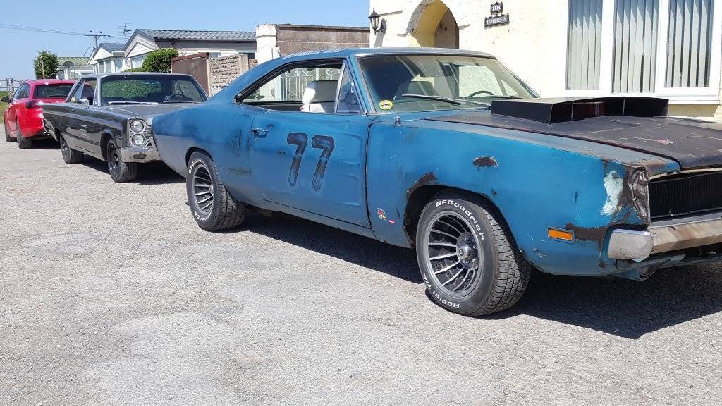

I don't know if you have ever watched Roadkill but your Charger give me a kind of General Mayhem vibe.
