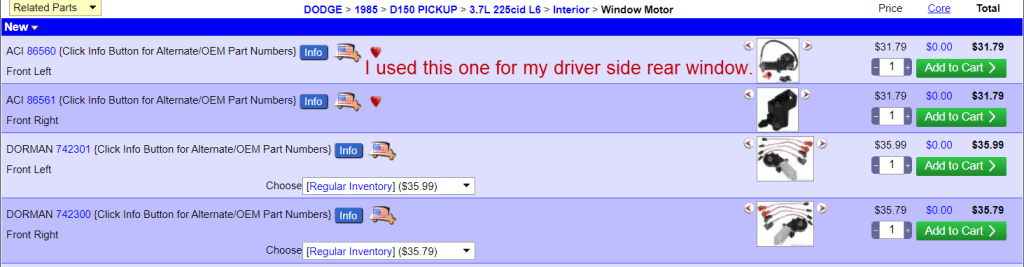

I am in search of a replacement power window mtr for a 1970 Dodge Polara. The current mtr is locked up. Dorman used to make replacements. Are they still available?
FYI
I used the window motor from a 1985 Dodge truck for one of my rear regulators. It is plastic but it bolts in and is much faster than the original motors.
