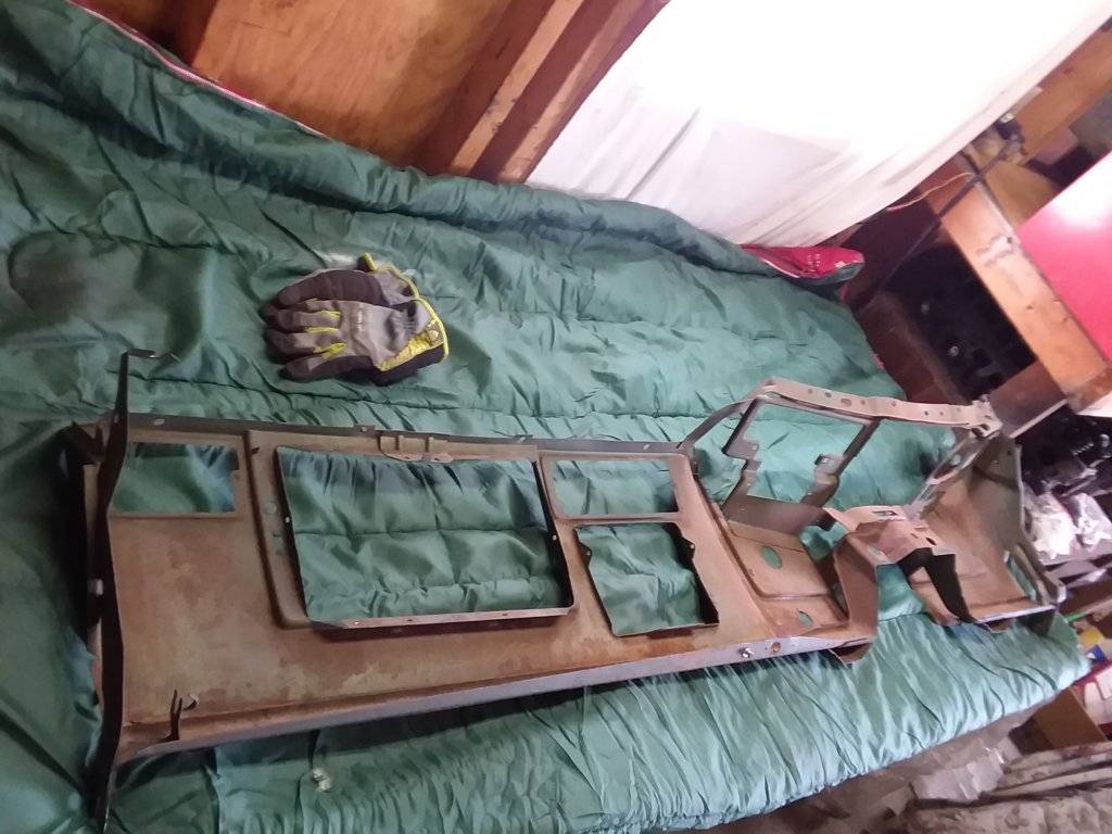

I have been using a die grinder and coarse discs to take my dash shell down to bare metal. I am planning on spray can prime & black paint. For filling small nicks and rust spots, what brand of primer do you recommend? The car is a driver. I am trying to hold down cost as much as possible. Taking it to a paint shop is not an option. Thanks for your recs!

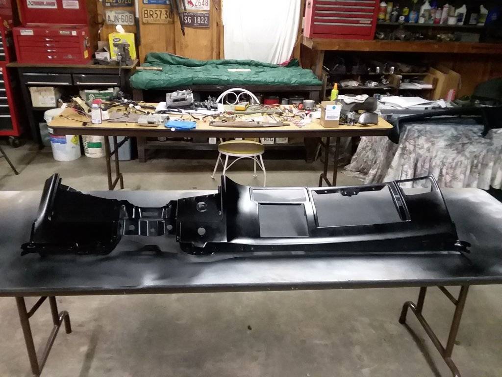

Dash Shell:
The rear I cleaned and then brush painted with a combo prime/paint to keep down rust

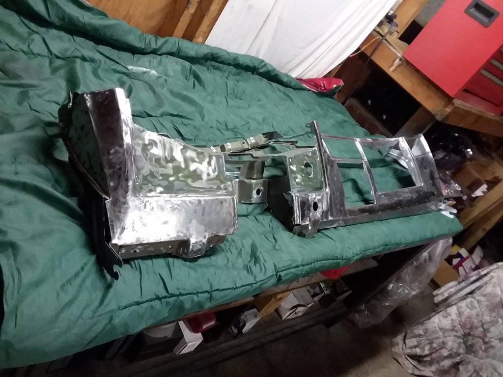

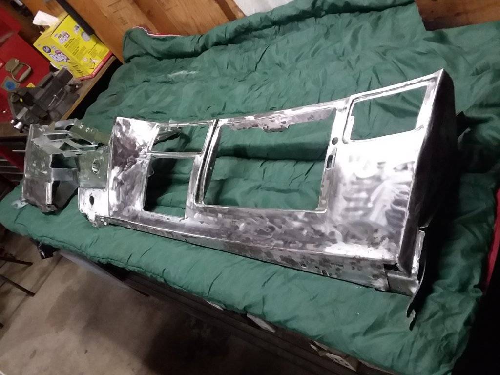

Placed shell on table outside garage door. I worked over the front side of it with a die grinder and a coarse grit 3M disc. Took entire front down to bare metal. Air compressor powered die grinder left metal very smooth.

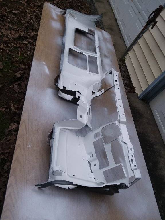

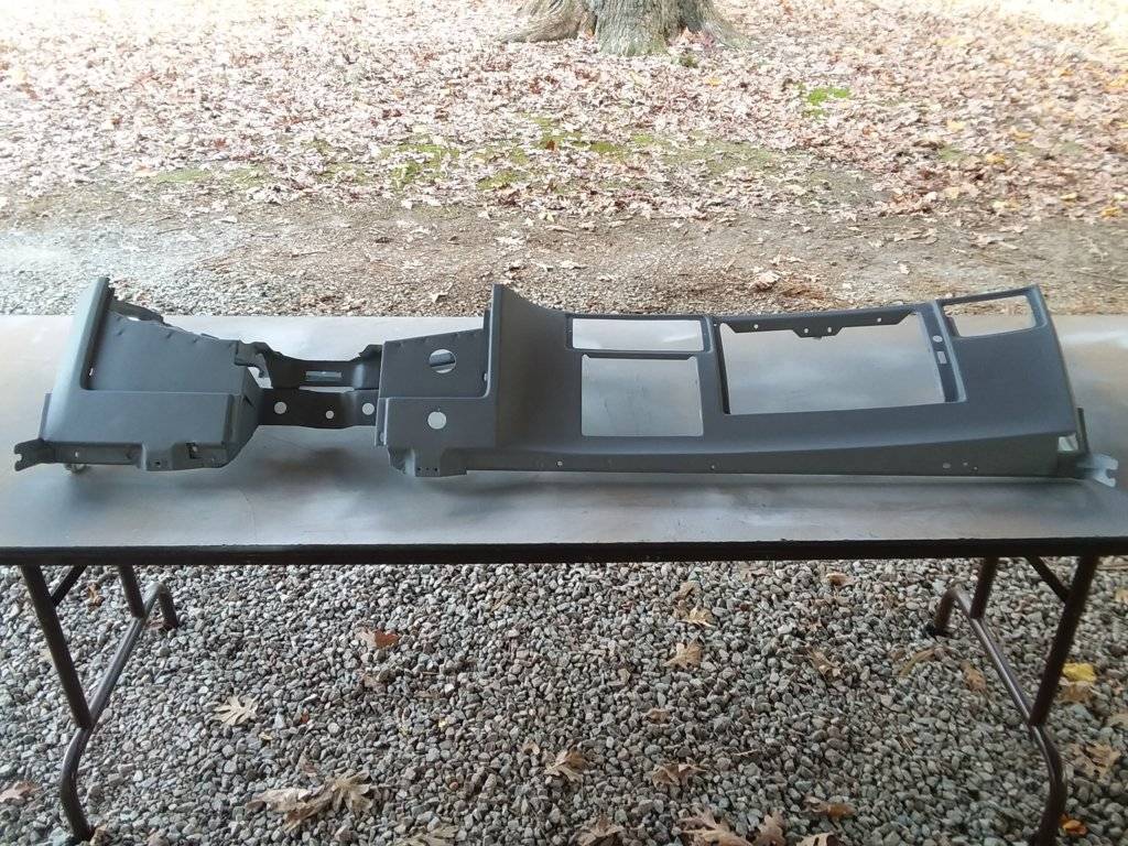

Duplicolor 2 in 1 Filler & Sandable Primer DAP1700 12oz $7.99. I applied the entire can in 4 coats on the dash shell. I applied in 30 minute intervals, temp 50°F. It went on very smooth.

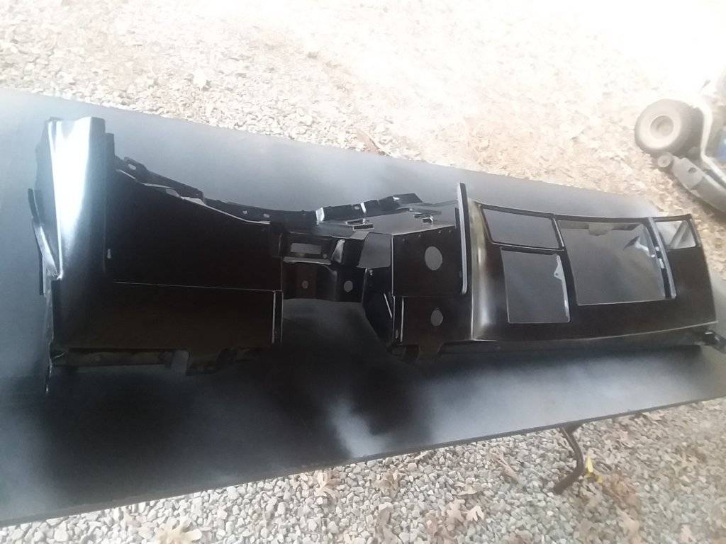

Duplicolor Perfect Match Brilliant Black Pearl BCC0427. Entire 8 ounce can was gone in 2 coats. I applied in 30+ minute intervals. I used 2 cans. Tried clear, which was frosty, looked horrible. 2 more cans of duplicolor black. I mixed different spray blacks because the parts store only had 1 or 2 of any one thing. I think the last can was actually Toyota black (The Horror!), although they all look black to me. Did not try another clear.
The Duplicolor paints are too expensive, but they do yield a nice non-gloss finish

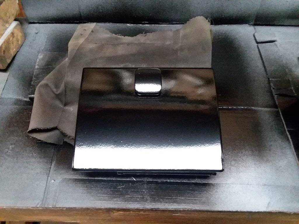

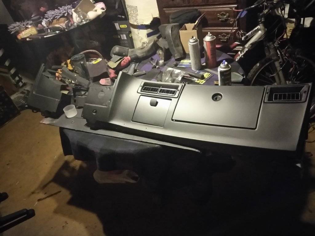

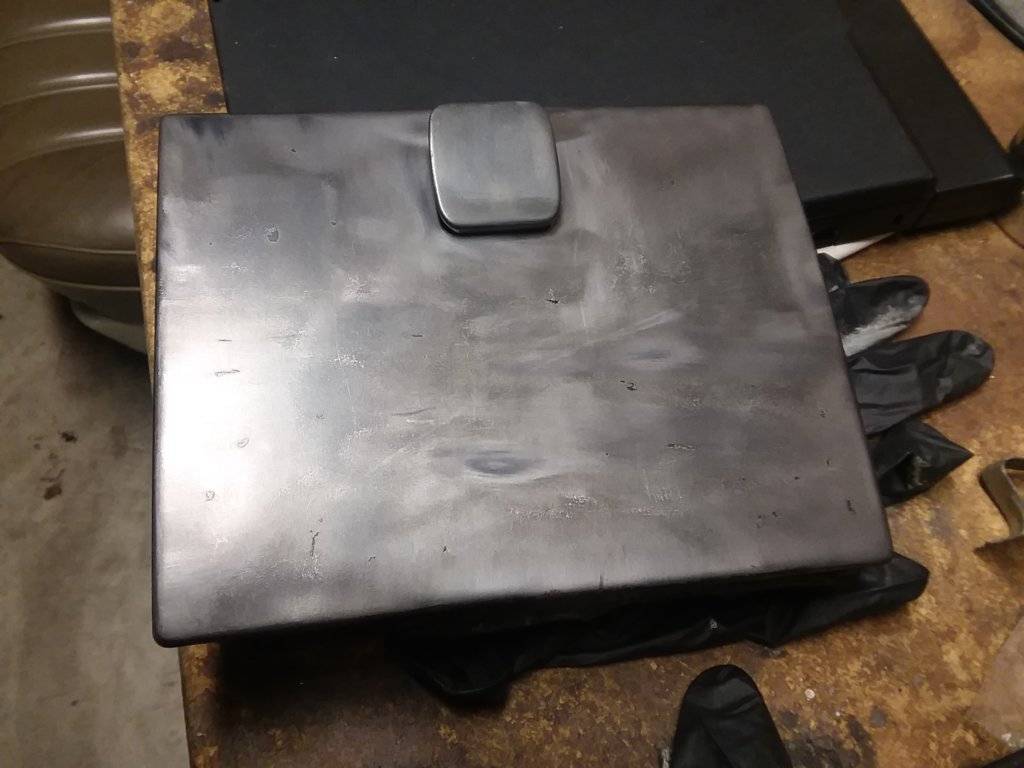

Just before and afters. I'm wrapping mine up right now. Keep getting fisheyes on the ashtray. Very frustrating.
I had trouble with my ashtray too. I had to use fillable primer, then overcoat with non-fillable, then paint it
