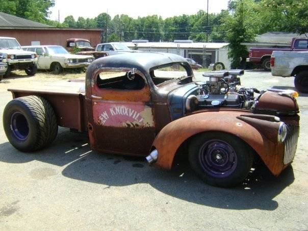

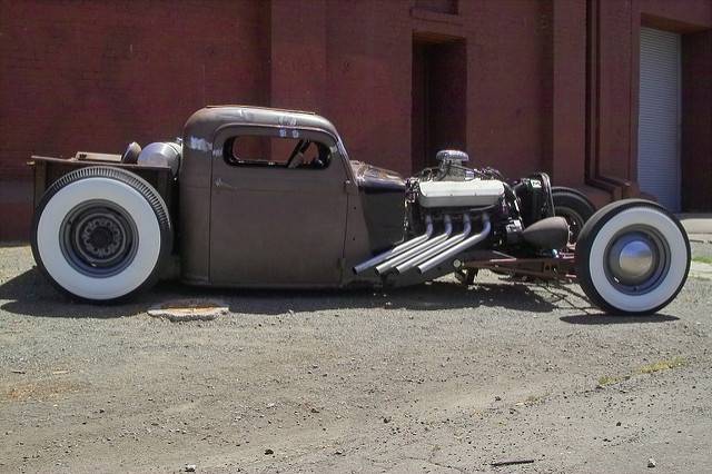

If you are building a "Bobber" and a low rider, and fabrication doesn't scare you, then this is all up to you how to do this. You'll need to fabricate motor mounts along with some sort of shifter. You might be able to use the upper part of the mount and build/adapt to the lower mounts. There are aftermarket shifters that you can use, or build something on your own, but obviously the stock stuff isn't going to work.
If you are looking to make it easy.... Then take a long look at putting the 318 combo in the bobber. Unless you are planning to go through the 383, it ain't gonna be a tire roaster anyway... The 318 is lighter, easier to fit into whatever frame you are using etc. Probably gonna be just as fast and cost you less money. Then leave the 383 where it is.
So your looking to put this 383 into say an "A" body car? You will be WAY money and time ahead, just buying a core engine and building it up for your race car project, and enjoy the Chrysler as your tow car.
I think he's building a "bobber" truck.
