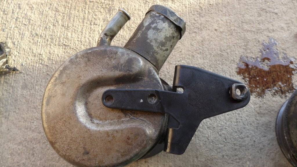

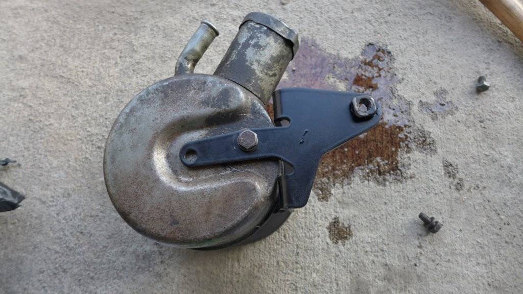

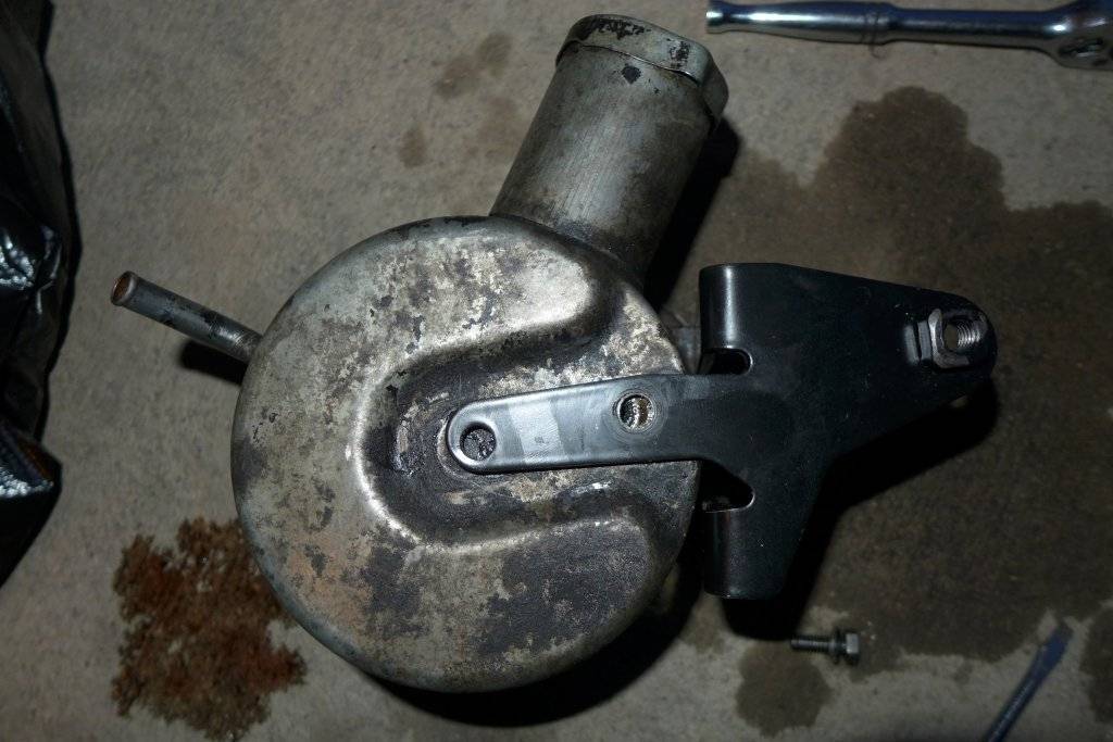

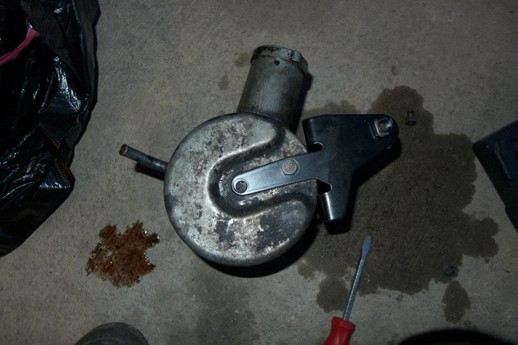

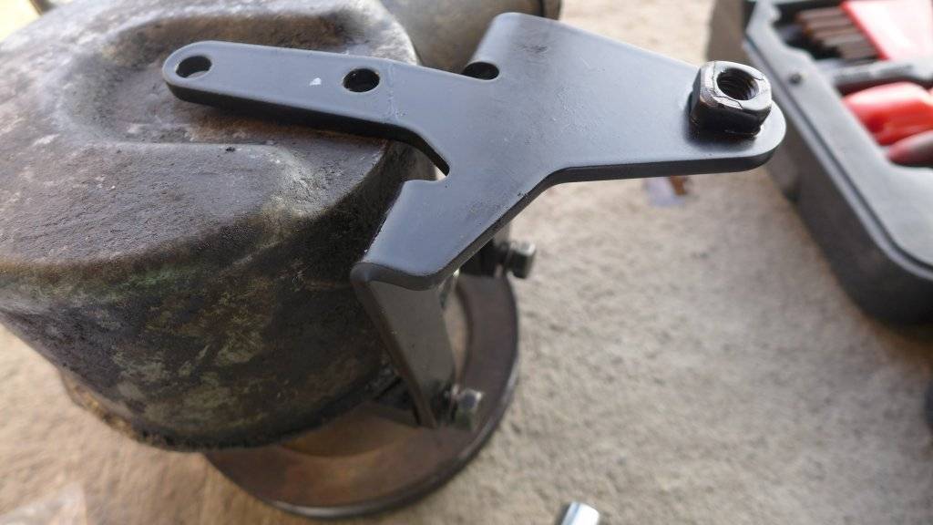

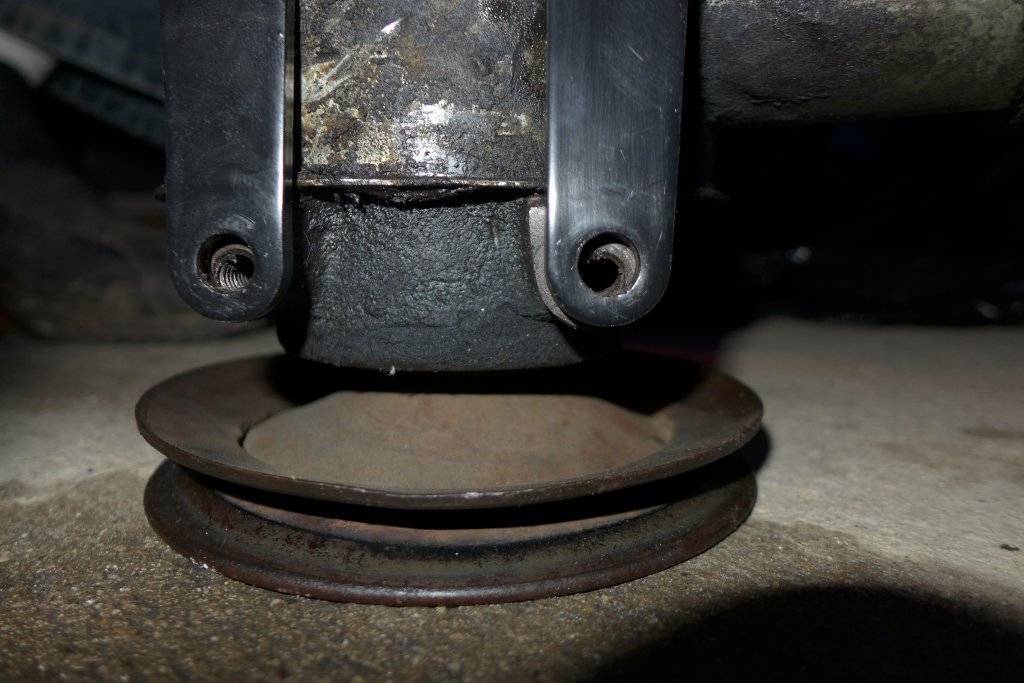

here's the photos two different years of trw pumps one's from the one off my car and the other is from 1970 newport

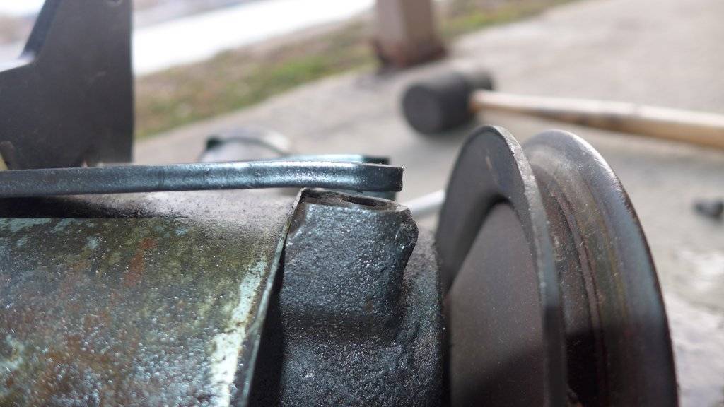

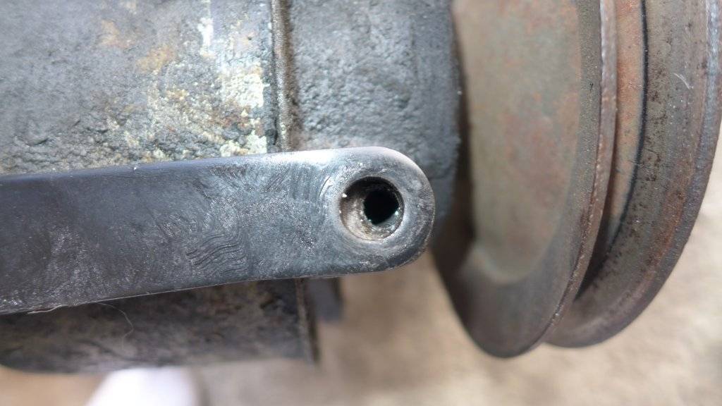

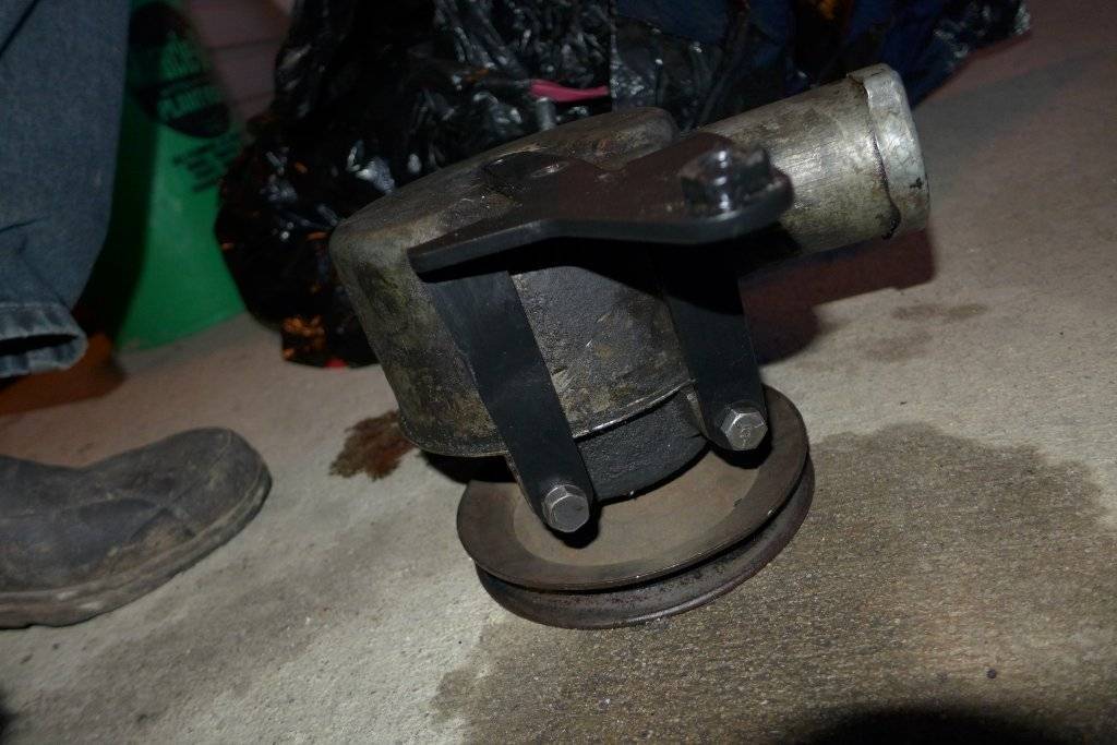

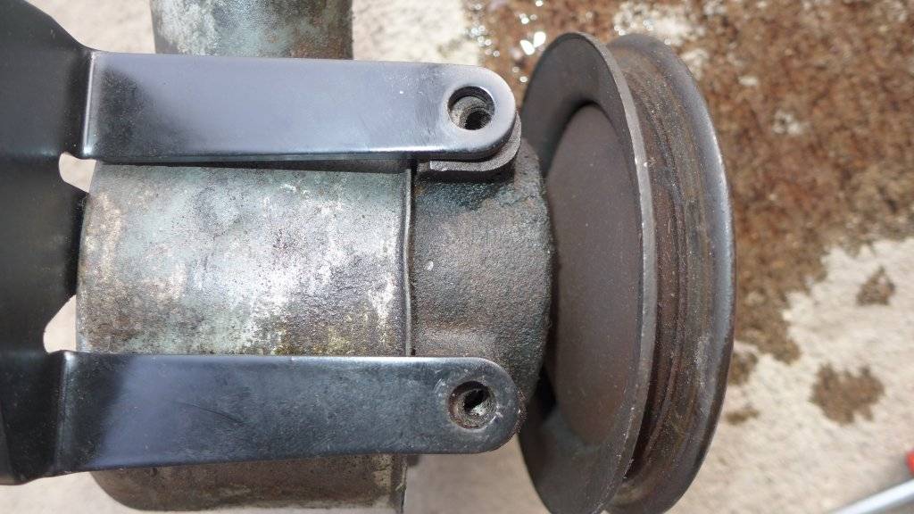

well you guys did ask for a few photos so i'm delivering
as you can tell nothing is lining up
Your pump looks a little different than mine. The return line is in a different place.

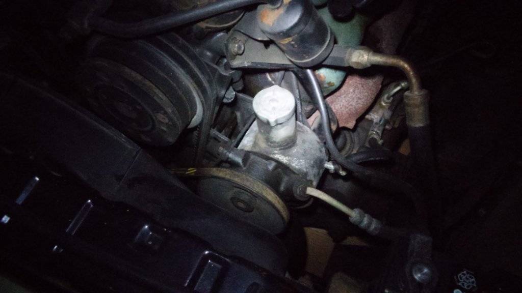

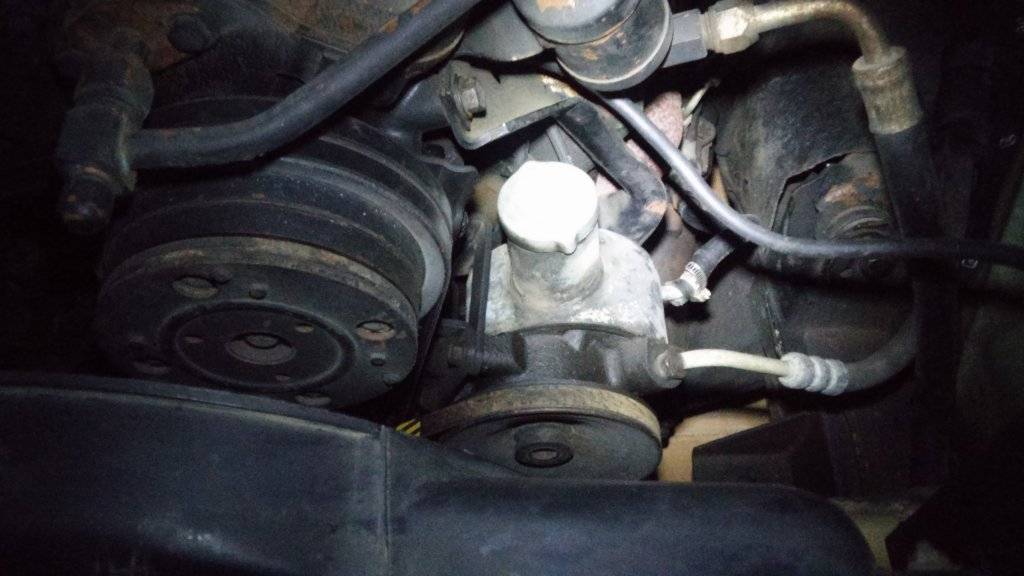

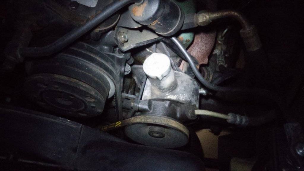

I snapped a couple of pics with a flashlight and my cellphone:
My pump only uses one of the holes on the back like yours. It's been 6-7 years since I installed the bracket, but it all pretty much lined up and dropped in.
You may have a different generation of the same pump.

the one with the return line is from 1970 m.y.

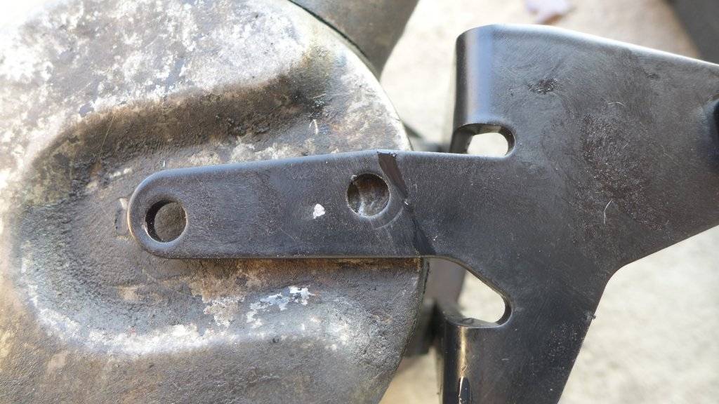

After looking at your pics again, it looks like you can probably "persuade" the bracket to reach the holes in the pump.

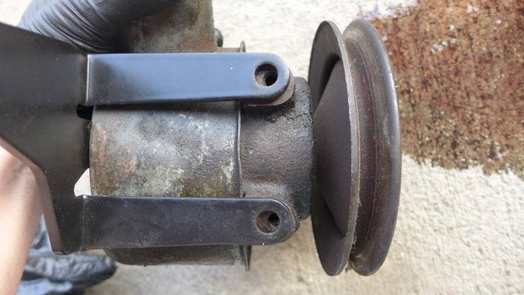

here it is with the return tube in the proper location...

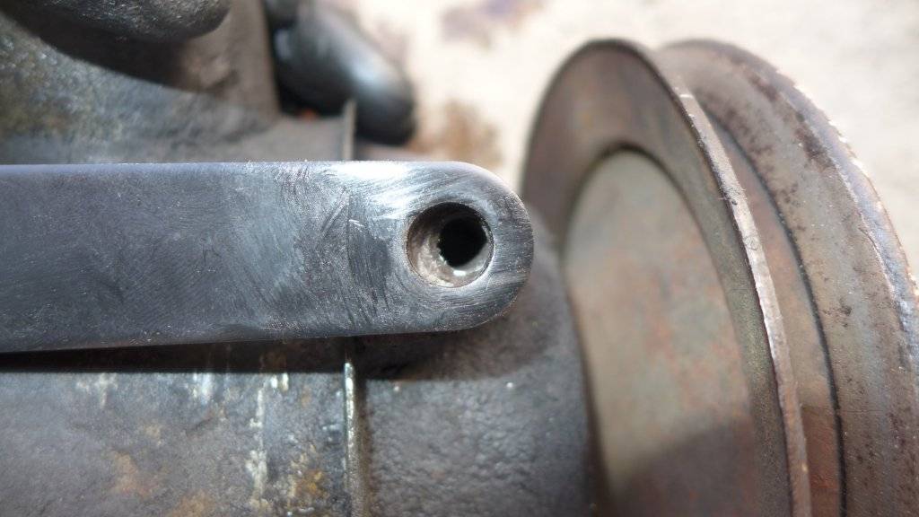

gonna take my losses and effort i put into this bracket. i wallered out the hole on the back to make it fit. (took about 1.5 hrs of work doing that) went to mount it up on the car nothing lined up pulley was out of alignment the bottom bolt for the adjustment could not be inserted, wasn't lining up...
which i think i got a friday build quality bracket
