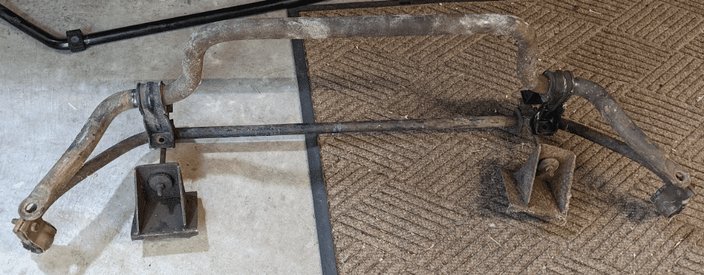

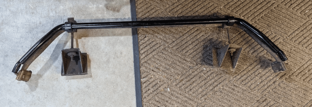

So here’s a pic I took, with them laying on top of each other -- the PST bar is clearly shorter and wider. (!!!)
This explains why I had such a struggle figuring out how to fit it.

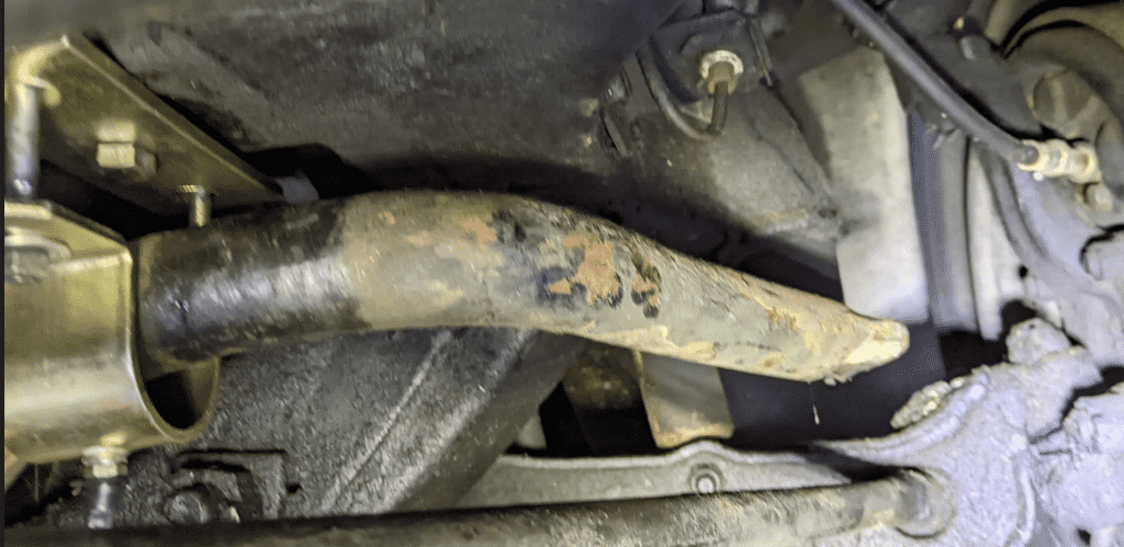

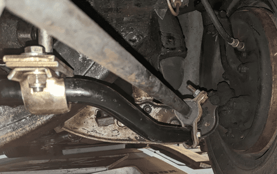

Here’s a pic of the Mopar Muscle installation. As we can see, their installation differs from factory, the end of the bar attaches above the strut rods.
And it looks like it’s not tightened properly either (read on). I say this because the bolts appear to be parallel (but the pic isn't the best)

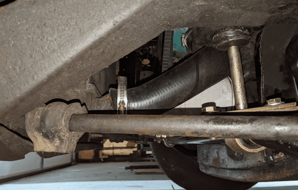

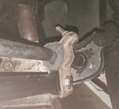

And here’s a pic of the bar as installed by @Zymurgy, routed below the strut rod as the factory did. I trust Zymurgy’s efforts far more than a magazine!

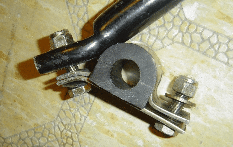

Sway Bar Endlink Brackets

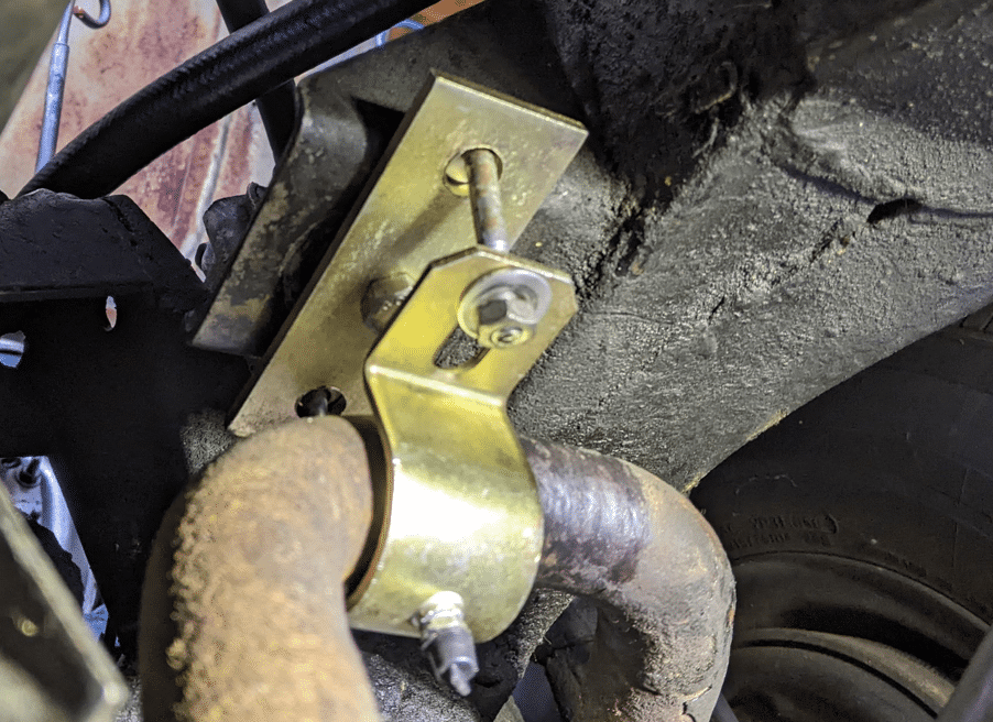

No blame to anybody, because my memory of the installation instructions is that they sucked bigtime (hand sketches and typewritten). Back in the day (2016) I tried a bunch of variations on mounting this bar: mounting it above/below the strut rod, and 2 orientations of the saddle brackets there + reusing the original strutrod brackets. I tried all 6 setups and none were correct, all of them ended up with the frame links angling toward the rear of the car. It must move rearward from the factory location due to being shorter/wider.
I had to bend the saddle brackets to get it to tighten up properly.
Zymurgy’s pic looks like the 2 bolts aren’t pointing the same direction, so I’d bet he had to bend brackets same as me.
In the above pic, the saddle bushing is oriented in the wrong plane, but is to show the bend.
My concern with this is: with the bar being wider, the mounting to the strut rod is cantilevered, and with the LCAs moving in an arc, the bolt thru the swaybar is going to see a lot of bending stress. OR - the saddle-bushing is going to rotate somewhat on the strutrod and not transfer the motion into the swaybar. The original bracket clasped both sides of the swaybar’s end, putting the bolt in double-shear (better enginering), and the bar terminated vertically from the strutrod, forcing 100% of the motion to the swaybar.
