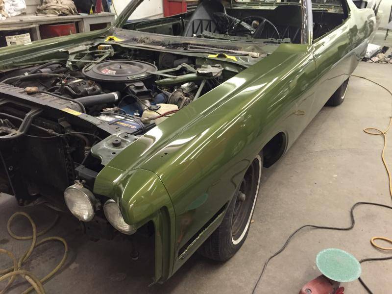

Here is the car in the shop (getting painted as well) waiting - motor may be out by now, waiting for new 440. I plan to pick her up in the spring with the paint complete and new motor. I will then work on interior myself, and plan to upgrade the suspension, rearend and brakes over the summer.
