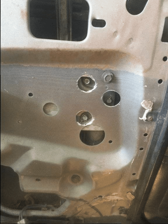

The easiest way is to drill 3 holes with a hole saw in the panel over the mounting bolts and just unscrew the bolts. This lets you leave the regulator in the body. That means no adjustment or fooling with the spring that can take a finger off. The hole saw just needs to be large enough for the socket with a bit of fudging if it's not aligned.
The window will stay up so no clamping is needed.

Thks looks like a great idea but how will I know where to drill the holes and then getting the motor out is easy?
I have a template in PDF you can print.
With those three bolts out and one on the motor the motor just falls out.
Take a good look at that picture and this one. This pic is my '70 300, so it should be the same as yours. The pic in my first post isn't my car, but I believe it is a '69.
What you want to do is look at the window motor through the openings and you'll see the 3 bolts around the gear drive that holds the motor to the bracket internal to the "door" area. (Yea, it's not a door as someone likes to point out. LOL.) Close is good enough and you can see where I didn't hit it the first time. Mark it with a pencil and drill a small hole to check and then follow it up with a hole saw.
There's also if you look in the first pic there's 1 bolt below those 3 that holds the bracket on the motor to the body that will need to be removed.

Thk u very much I will give it a shot over the next week and let u know how I make out Thks agian
Worked out great motor came right out Thks very much!’ Now I just need to find new brushes and springs one ones fried.
