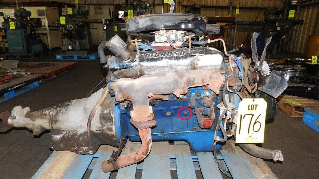

On either side of the block is an NTP pipe plug along the line of the "freeze" plugs. They're just behind the mounts. Unscrew plug, break the crud that's probably "sealing" that hole and you can drain the block to nearly dry. This can be a bit messy with a hole the size of your pinky gushing coolant, but a strategic bucket will get most of it.
This will eliminate the annoying weeping out of the exhaust stud hole every time you lean on the fender to do something.
Pic is a grab from the interweb. I'm not responsible for this ugly mess.
