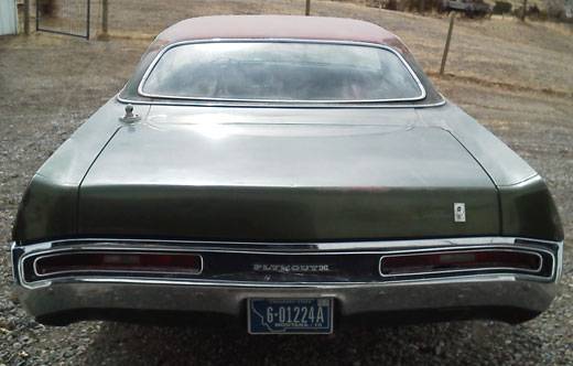

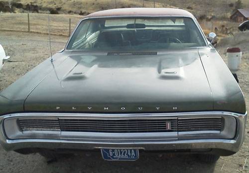

Hi all,
I recently ran across an ad for a 70 Sport Fury for sale... The seller to sent me a couple pics including fender tag...
I'm still relatively new here and could use some expertise.
The car looks like a Sport Fury to my knowledge...
Has the hidden headlights, Sport Fury on the side marker lights, has the RW&B emblem on the grill, Sport Fury scribe on the interior door panel.. but I thought all Sport Fury's had the "Strobe Stripe" and if it was a GT or an S23 there would be a decal on the deck lid stating so...
I also saw a picture of an alleged S23 and it had the S23 on the deck lid and it also had S23 at the end of the strobe stripe...
The car I'm looking at has no strobe stripe.. it has body side mouldings and I don't see S23 anywhere on it...
Is there any way for me to determine if this car is a real Sport Fury or an S23?
I read the S23 Sport Fury's came with 318's...
This car is a 318 w 3 spd manual on the column... kinda strange I thought for a Sport Fury.. but what do I know??
Below are pics of the car and the fender tag...

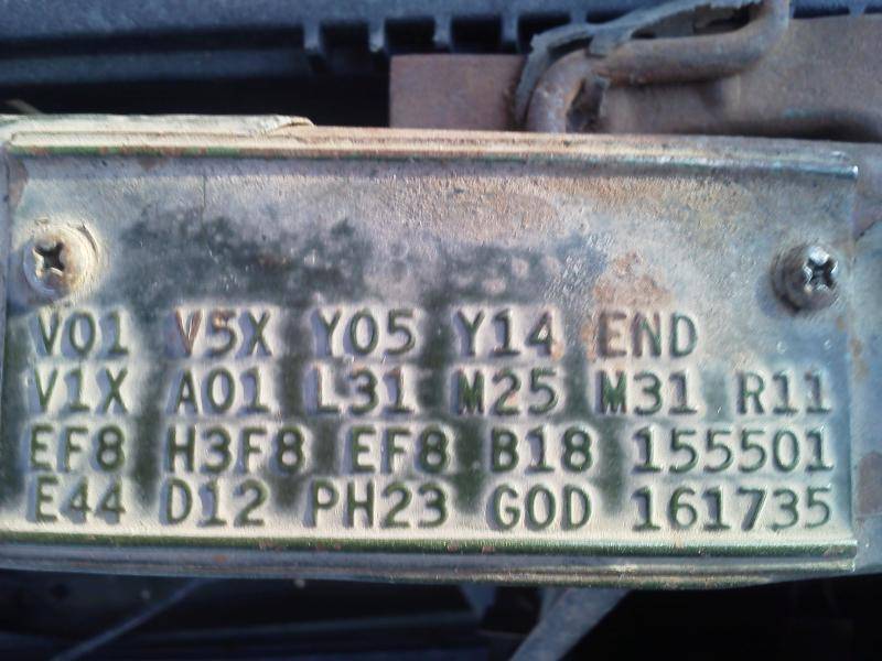

And here is the results from an online Mopar Fender Tag Decoder:
PH23:
Plymouth Fury
High
2 Door Hardtop
G0D: 318 230HP 1-2BBL 8 CYL
1970
Belvidere, IL, USA
161735: Sequence number
E44: 318 cid 2 barrel V8 230hp
D12: 3 Speed Manual Transmission-Column Shift 8 Cyl.
EF8: Dark Green Metallic (Dodge), Ivy Green Metallic (Plymouth) Exterior Color
H3F8: Trim - High, Cloth/Vinyl Bench Seat, Green
EF8: Dark Green Metallic (Dodge), Ivy Green Metallic (Plymouth) Int. Door Frames
B18: Build Date: November 18
155501: Order number
V1X: Full Vinyl Top, Black
A01: Light Package
L31: Hood/Fender Mounted Turn Signals
M25: Wide sill moldings
M31: Belt Moldings
R11: Radio Solid State AM (2 Watts)
VO1: Unknown
V5X: Body Side Stripes, Black
Y05: Build to USA Specs
Y14: Sold Car
END: End of Sales Codes
Any help would be greatly appreciated.
Thanks!
JK

Hi,
it is "just" a regular Sport Fury.
An S23 would have the A51 package on the fender tag, a GT the A52 package.
Both versions would came with a side stipe, not the side molding, too.
This green car is for sale since ages
Carsten
All sport furys DID NOT have the strobe....I believe only the S23 and the GT had the strobe, but their own version
And I'm sure those could have been deleted with the stroke of a pen upon ordering but that would be on the tag. This one came with the very rare GOD option...
V01=monotone paint.
I like it, green or not. Anyone else know of a '70 SF with a stick shift? I've never seen one.
yes, the strobe was just available on both performance versions. Only difference is the letters (S/23 vs GT)
All regular sport Furys do have the side molding which disturbs the good look in my opinion.
