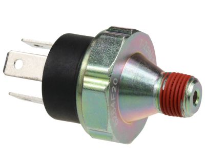

I was flipping around rock auto, checking a few different years for the 318 oil sender switch, I figure the threaded hole in the block is going to be the same for a lot of different years, I see this sender:
Looks like what I have, except it has 3 contacts instead of 1. How does this one work?
That is also for a guage/light. I have the single wire if needed, $20 and the ride
I'm going to buy the 3-wire sender, I figure one of the wires is for the oil light, the other 2 are a piezo-resistive element that reacts to pressure. I'll build a circuit to get a signal out of that and I'll have an oil pressure reading, put a readout in the cabin somewhere.
IDK what parts houses exist north of the border but NAPA has the correct one (Echlin op 6282) for 14 bucks and you don't have to pay RA's shipping which is probably more than the switch...
