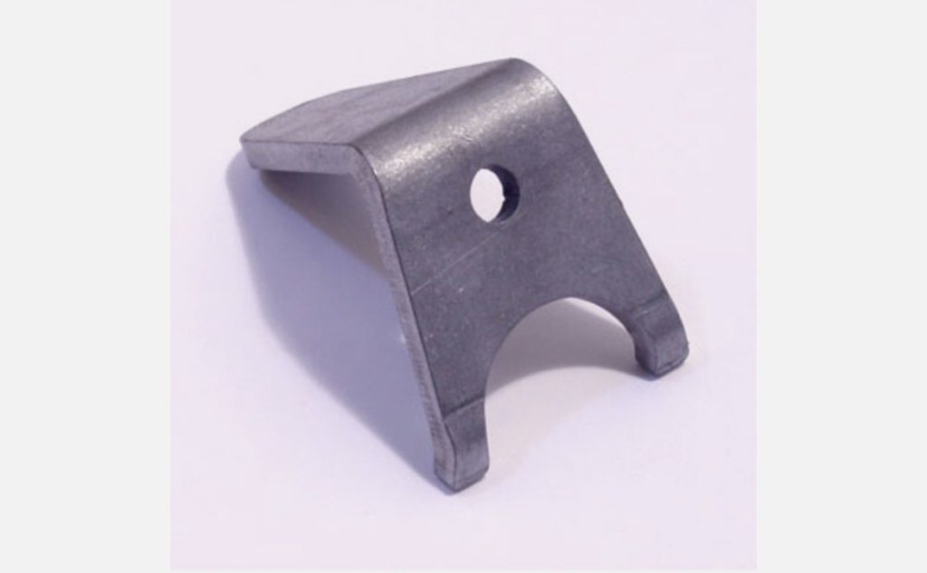

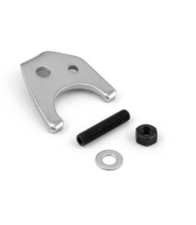

The distributor holds the gear down. A distributor bracket holds the distributor down. Big block and small block shown below.

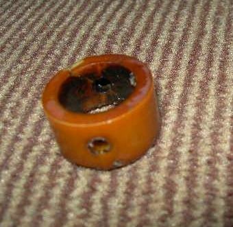

No, that just holds the distributor shaft in place. Halifaxhops has new collars. It looks like you need one.

The distributor doesn't keep it in place. The plastic collar you've shown just keeps the end play of the distributor shaft to a minimum.
