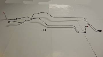

One of the trans cooler lines, as it reaches the rad, makes a U-shaped bend for no apparent reason. I think this is the front (pressure) line, as it reaches the driver's side radiator port. I thought that maybe this was a fluke, someone's idea to use up some extra pipe. Here's a photo from Van's showing their pipes:
See how the one pipe could go straight into the rad, but makes a U-shaped detour.
Is this to act as a sort of strain relief? Is it needed if the pipes are made from copper-nickle?
Bends can be for several reasons. One is for clearance as the car is assembled on the assy line. Another is to have a particular shape to decrease any harmonics (vibrations due to length) of the line, to minimize cracking of the line over time.
Rest assured, there IS a reason or any OEM would not have spent the money for those bends and extra length, even GM.

It is there for a reason. Flexing. The engine and trans are on rubber mounts, the radiator is solid bolted to the body.
Ever wonder why brake lines have circles bent in them? Same reason.
Well, I just bent a new pair using copper-nickle tubing and I didn't put the U-bend in that line. Both lines have a ways to go from the rad to the next place where they're fixed to the bracket under the starter, looks to be enough for me. The curly-que's from the MBC to the distribution block for the brake lines is a much shorter distance.
I think the U bend will line up with your oil filter giving a little more clearance to remove.
Ok so the bend must not be relevant for the 318. It lines up nicely for my 383 which is the drivers front
