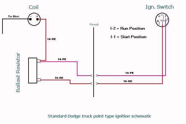

Since the ballast resistor is NOT used in the starting circuit, it won't make any difference there.
Note that the start position uses the circuit marked 14-PK and the run circuit uses 16-RE. Twist the key to start and the ballast is bypassed, release to run position and now the ballast is in the circuit.

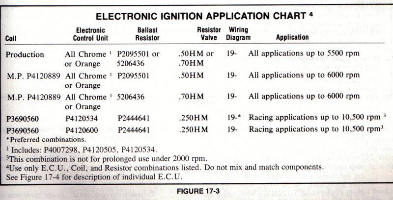

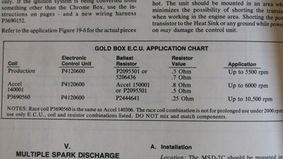

As long as it is rated the right ohms for your system it is fine. A ECU definitely have to be matched for best performance.
