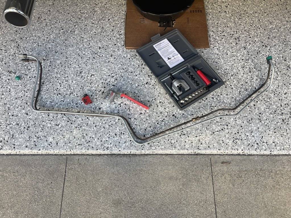

I just went through this myself. I had a leaky steel line where someone had spliced in a union years ago and that was the source of my leak. I removed the old line and used it as a template. I remade a new steel line using 5/16 line, double flared the ends and added the connector ends, leak fixed!

I purchased pre bent lines with the flare fittings in place. A little arm wrestling to put in between the engine and K frame, but pretty simple otherwise. Certainly not $300 worth of parts and labor. $45 for the pair.
