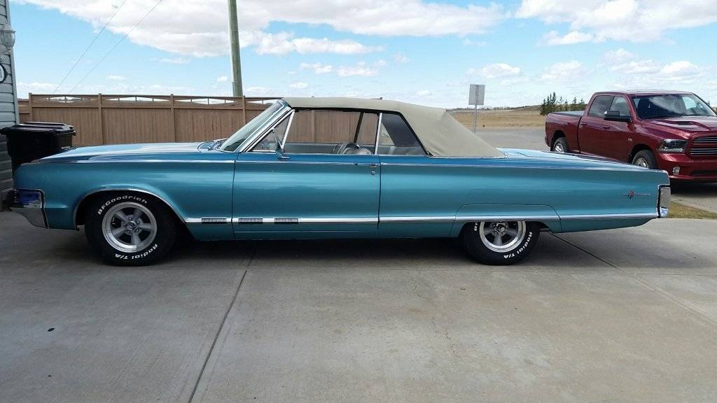

Here's 235/70s on 7"
20160409_125411_resized-jpg.76031
Sorry to revamp a old thread but, I have been searching for wheel and tires sizes and found the wheels that I wanted on ebay..... now I just found this thread/picture and those are the wheels that I thought would look good on my car. I was right they look great. I was thinking of going 17 X 7 (215/65R17) instead of 15's but non the less, they look great.
Beautiful car BTW.
