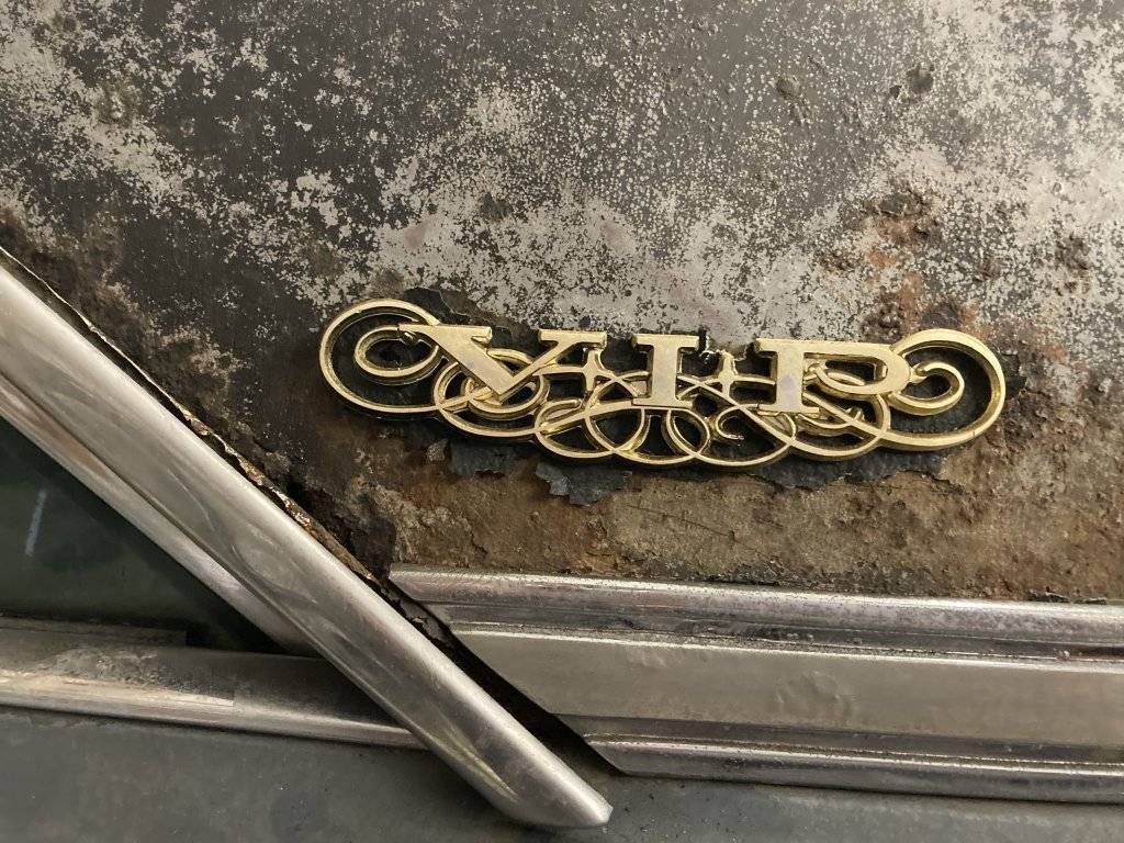

How is the VIP emblem attached to the roof (see pic)? Do lift it off with a tool or is it a screw?
Thanks, rsh
I believe that there are nuts that screw onto the emblem posts that are accessible if you carefull remove the headliner material on the interior C pillar. Good luck.
Judging by the condition of the roof, that emblem must be gold plated to be in such good shape. ?
Yes there are nuts under there. Be careful the old headliners are brittle and will crack or rip so easy.
The C-pillar upholstered piece is held on by the same clips as the doorpanels, IIRC.
For a VIP, I assume there is a funny-shaped piece of chrome at the bottom - Sport Fury and 300s have such a piece.
Might need to remove the trim around the back window if the C-pillar piece is tucked under that (I don't remember).
But my point is - be careful, of course, but you're not really dealing with the headliner.
