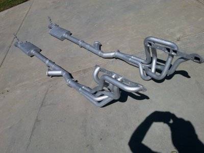

Hi guys, have a question related to exhaust fitment on my 66 Sport Fury. I was offered a great deal on a system from a 66 Coronet, question is, would it fit on my car. System consist of headers, no cross over, mufflers and they dump in front of the axle, they do not go all the way back. I was unable to post a pict. Am just getting familiar with my C body, so any help is greatly appreciated,
Rob.
NO! They are not even close. B and C Body exhausts are very different, especially the head pipes as they come down on different sides of the torsion bars. Sorry.
Ok, thank you. Here is a picture of the set up,
