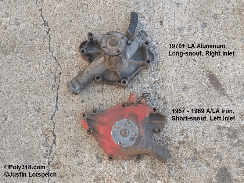

Just to be 100% sure we are on the same page, right=passenger side and left=driver side. Correct?
The reason I ask is the later (1970 up) small block water pump will bolt on to that poly and the outlets are on different sides. This is kind of opposite of your left/right description, but it does make sense if you are facing the front side of the radiator and referring to right/left from that direction.
Taking it one step farther, a water pump swap could be a solution.
