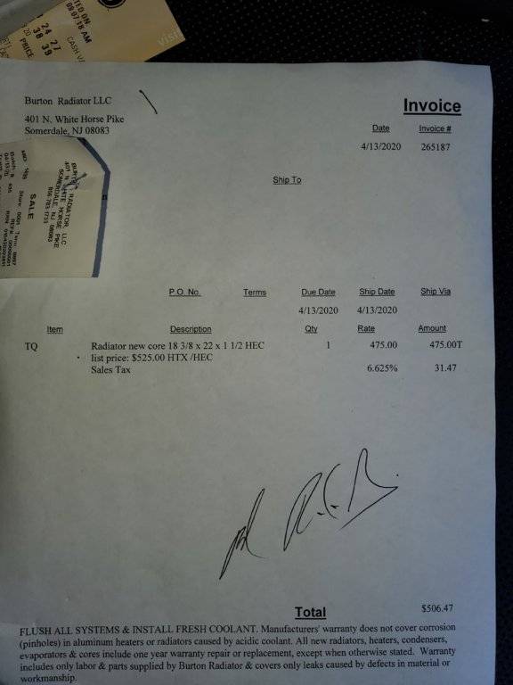

My bill from last week ...
But that hasn't changed much from 13 years ago when I did the last one.

Dave's bill above represents a high efficiency core for a 22" radiator for a non-a/c car and I have found that lately I am approaching $600 for a 26" wide a/c radiator with 3 rows of tubes (my radiator guy believes that going to 4 row cores is not a plus unless your car overheats on freeway cruising which is never the case for me at least and just adds more mass to cool down in traffic that would actually be a minus). Actually the cost of the recore for me hasn't changed all that much from say 8 - 10 years ago since I can't recall ever paying less than $500 for any high efficiency recore job, which mimics what Dave is also saying.

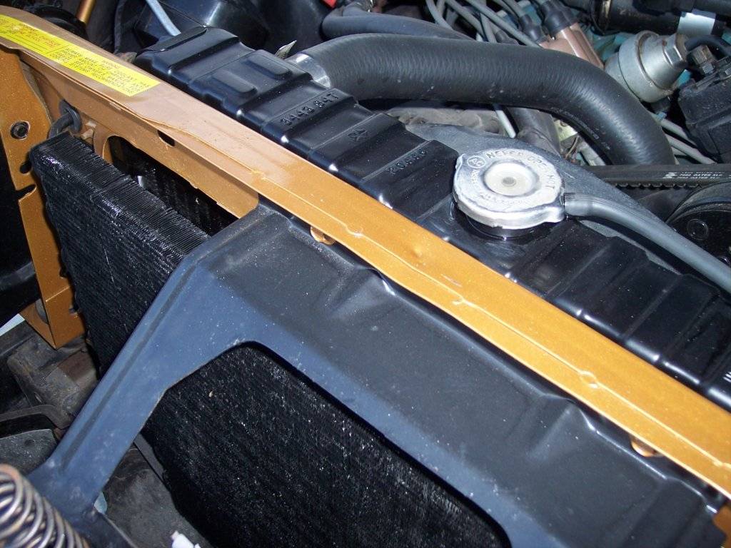

The only reason to go to Glen Ray is to get a really competent job done but the surcharge is hardly worth it given the radiator guy I currently have. I have one of the Glen Ray versions in one of my 71 300s (photo below). It looks great but cools the same.
