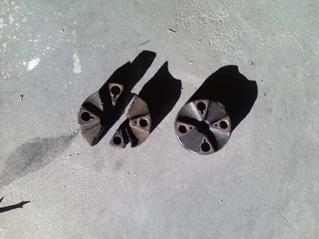

I replaced my old warn out rag joint with an OEM replacement. I performed the repair in conjunction with the steering gear box replacement so it was very simple to do with the steering column removed. I have included a picture of the old and new couplings. :eek:s_dancing2:
I paid about $100 for the new part which I felt was a bit high. :soapbox:I felt that it should have been about $20 but I am a notorious cheapskate. Still the sellers have us over a barrel since they know the OEM/direct bolt in convenience and appearance is very appealing. The improvement was immediately noticeable and overall worth the high price.

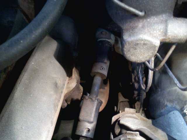

My 73' NCSHP Polara has a different setup than my gold civilain model. I noticed on another police packaged car that it too had the dual pot coupling setup. The rebuild price for these are a much more wallet friendly price of about $10-$30.
