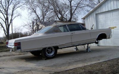

I removed the original disks on the '67 New Yorker and put drums on with new Moog joints.
