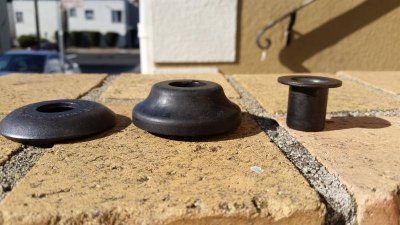

The only visual difference I see is that it comes with a different type sleeve (one for each bushing) rather than the factory tubular one for each pair.
The bushing set from Rare parts is stated as "High Performance" and I attribute that to the sleeve design. With a collared sleeve for each bushing I'm thinking that it provides a more rigid support of the bushings on the strut rod vs the factory sleeve being just slipped thorough both front/rear bushings.... I'm not an engineer so I don't know.
Another visual difference is the dome side of the retainer is flipped upside down rather than capping the bushing as the factory install. I don't know if the orientation really makes a difference. I could just orient the retainer upright as the factory (pictured in 1st shutterfly photo).
I reached out to Rare Parts tech dept. to inquire as to the correct installation and they indicated to install as received. They also stated that they did NOT manufacture the bushing set, but that they were OLD MOOG Stock.

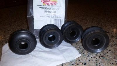

For what it's worth, I will say that visually comparing the bushings rubber composition from K7027 (actual) vs the photo that Moog shows on their site, the bushing from K7027 does look more (dense) heavy duty. I also believe the individual sleeves in K7027 (one for each bushing) would provide more strength and rigidity to the strut bushing than just the single factory sleeve that slips through both the front/rear bushing. As they say, you get what you pay for and it's the law of economics of supply/demand.

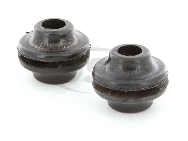

Moog's k7019a photo from their site -
Moog's K7027 High Performance Pkg (Rare Parts PR15450)

Rare Parts Actual Packaging
