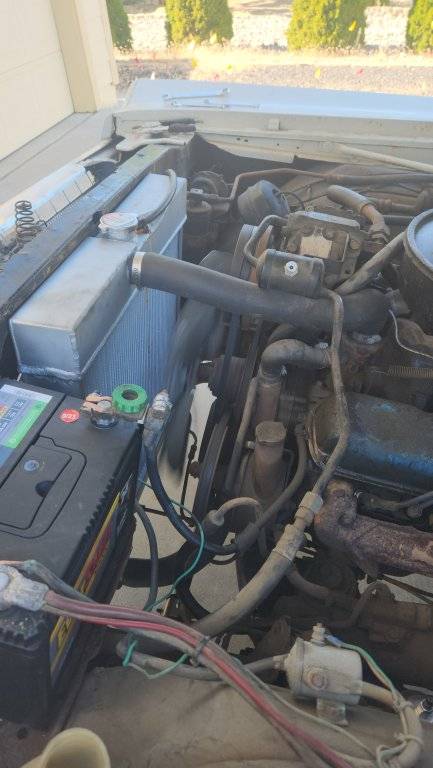

Was driving my 1969 fury home wheb this awful rattle/scrape started. It does it pretty much constant and fluctuates with rpms. It sounds like its coming from the front pulley/engine fan area. It'll stop very rarely.
It's a 69 318 with factory air. This happens without the AC / blower on. When that turns on the scraping/screeching is super loud.
See link for video/sound.
Thank you all in advance!
Water pump bearing? If you grab the fan with the engine off and shake it will it move? Any signs of any coolant leaking in that area?
Fans and pulleys all seem tight. It sounds like its coming from the new alternators side. I'll upload a new videi
