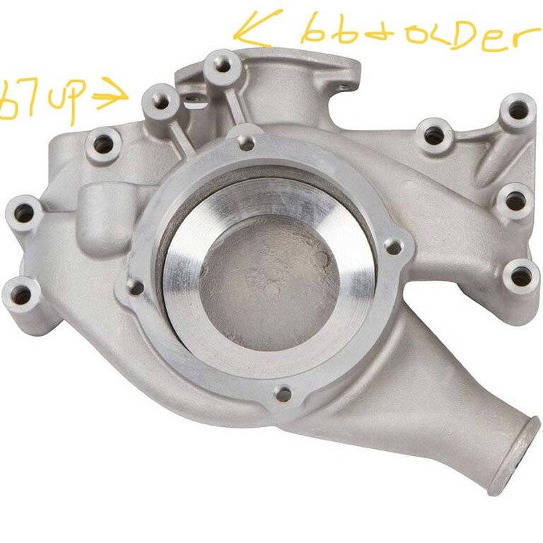

Drew you need one from a 1966 and older. The alternator bracket bolt boss on the water neck is moved and the temp sender locator is moved on a 1967 and newer housing.
many new aluminum housings have both bolt bosses on them now.

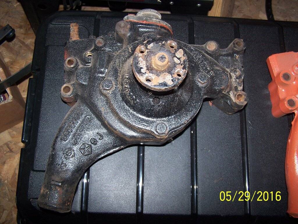

I have this one from a 67 440. $45.00 plus shipping I also have one from a 74 with the outlet on the passenger side. Same price.
