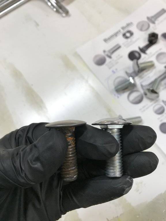

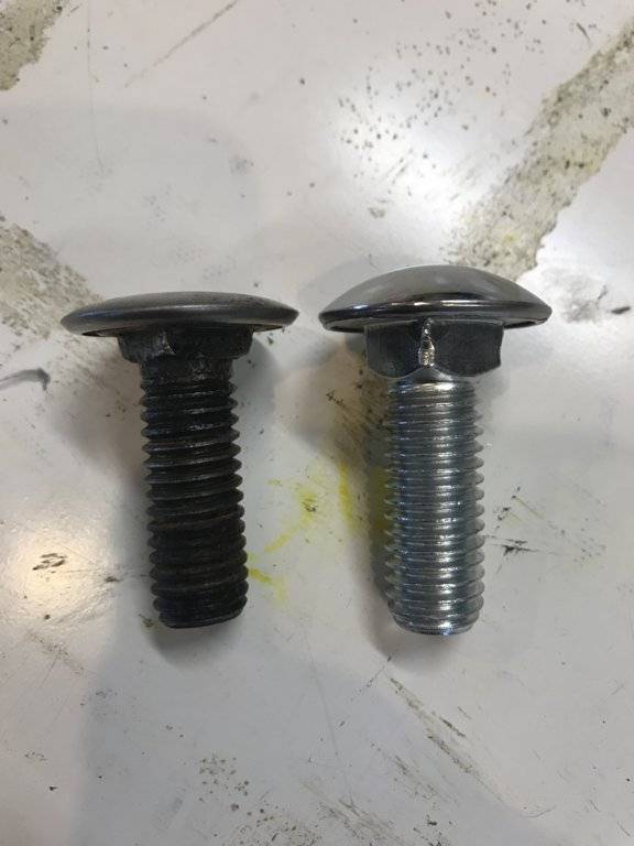

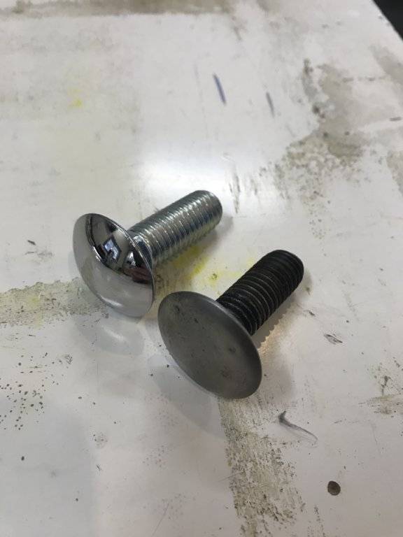

Received my bumper bolts from Mr. G’s.
They are pretty close. Head size is the same. The square shoulder is not quite as deep, but should be fine. Head has a little more dome than the original, but is much flatter than the carriage bolt style I got online a few weeks ago.
I think it will be very hard to tell the difference once I get them on.

IMHO those are not the correct bumper bolts. They have a rounded "GM style" head vs the "pan head" style that Chrysler used. I think they sent you the wrong ones. Chrysler used stainless caps.
