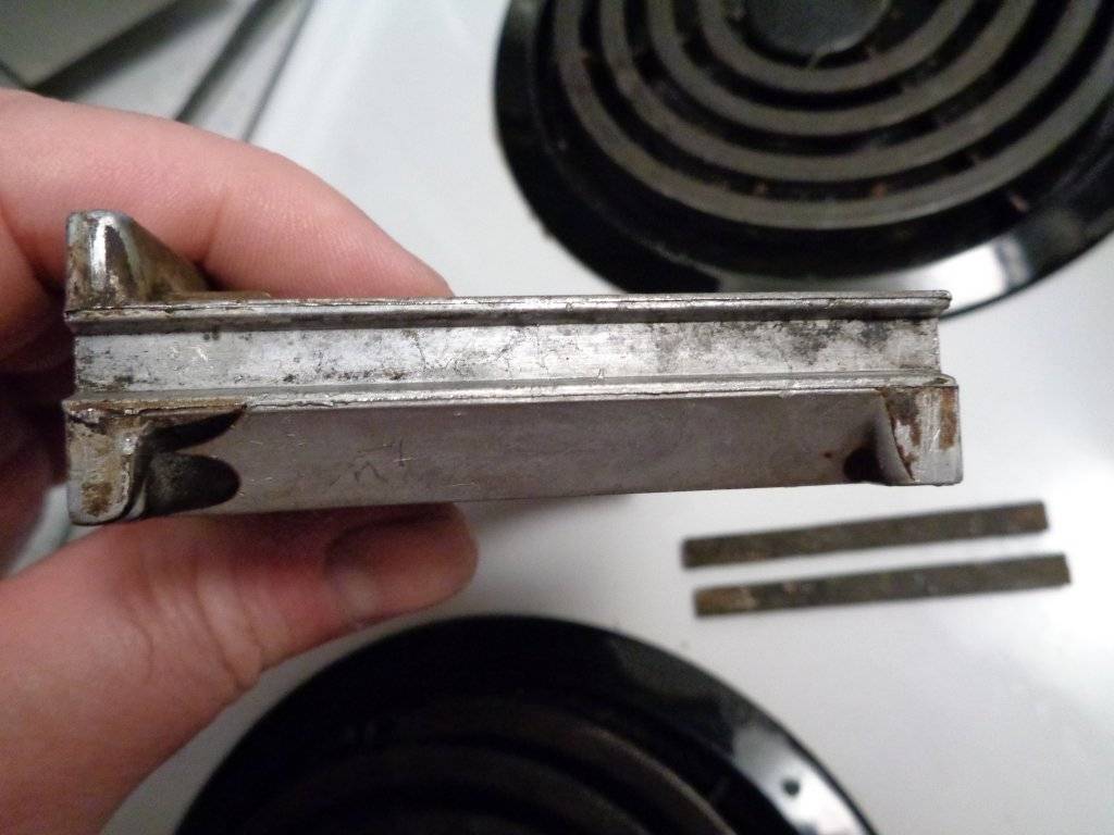

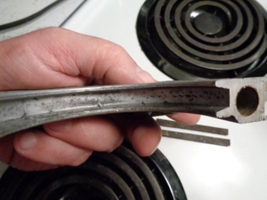

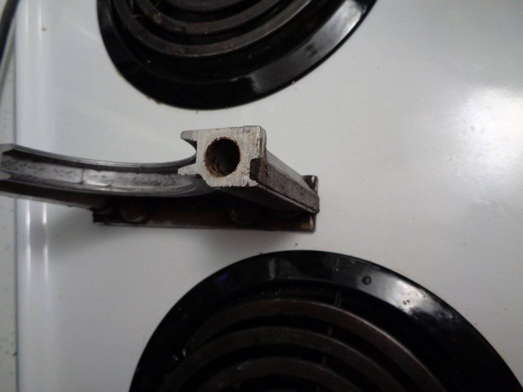

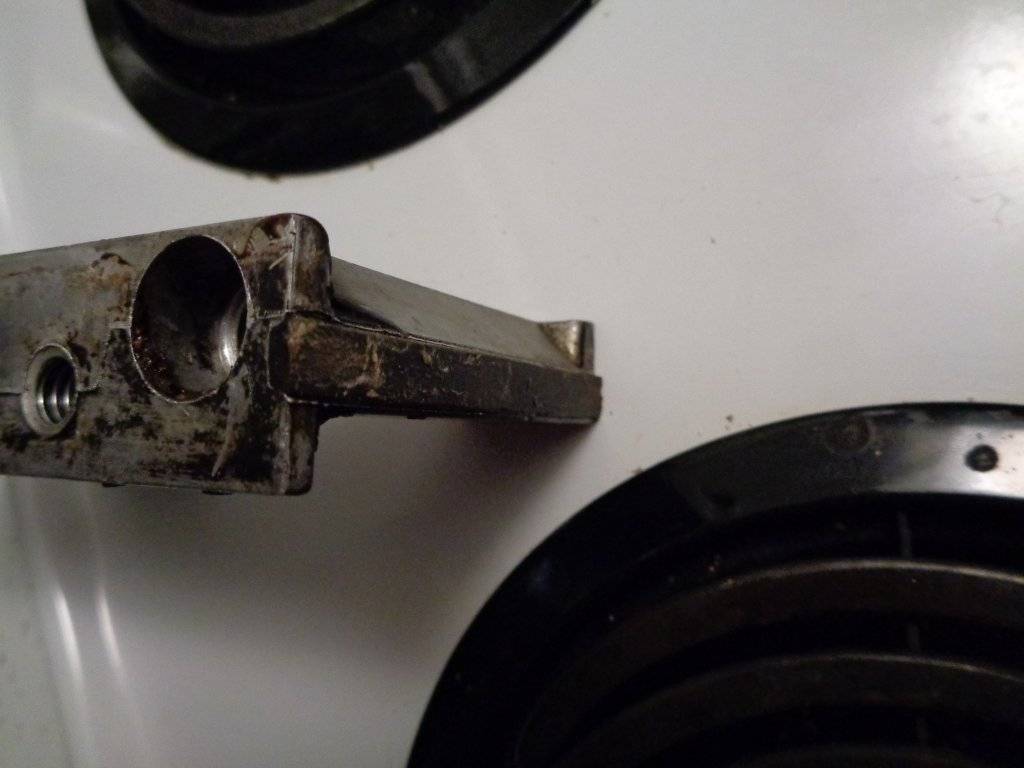

I am starting to stress out about how to do the rear seal. The crank still has the knurling untouched.

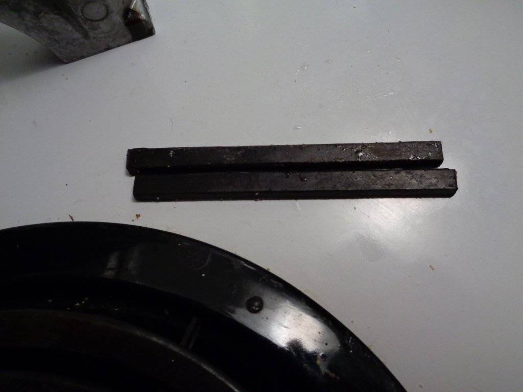

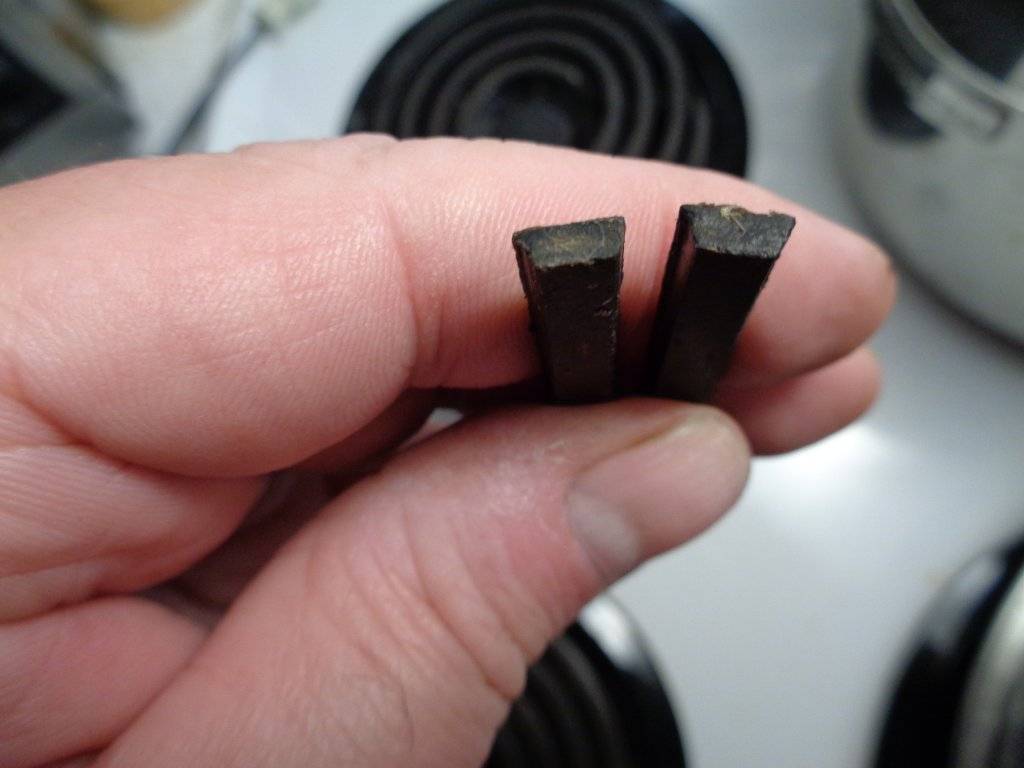

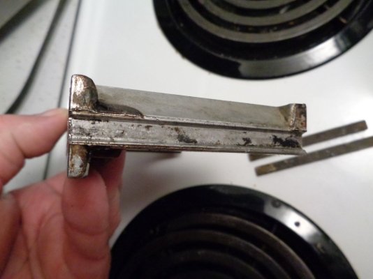

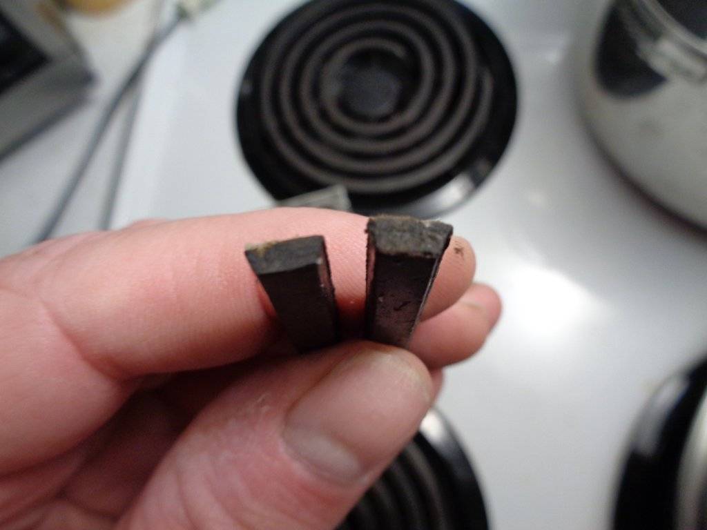

The seal plate had these plastic inserts that look like they are in good shape. Should I reuse them?

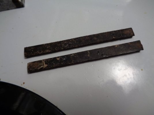

Does anyone know what the black glue was they used at the factory? It looks like they used it across the top with the pan seal too.
I been trying to scrub the glue off with soap and hot water and a pot scrubber. It has some "spikes" to grab the rope, I'm trying not the damage them
This seal is the scary part for me.

It does but its a rope seal. I see guys using pipe cleaners and silicone. The original plastic pieces fit tight.
It seems like the factory used contact cement and maybe this?
I do watch nick and he had that leaky 383 nightmare. I want to avoid that at all costs. I think he got a new crank to fix it. I didnt get my block line honed for that very reason
Your going to keep the rope seal or use rubber? Use new side seals or silicone instead
