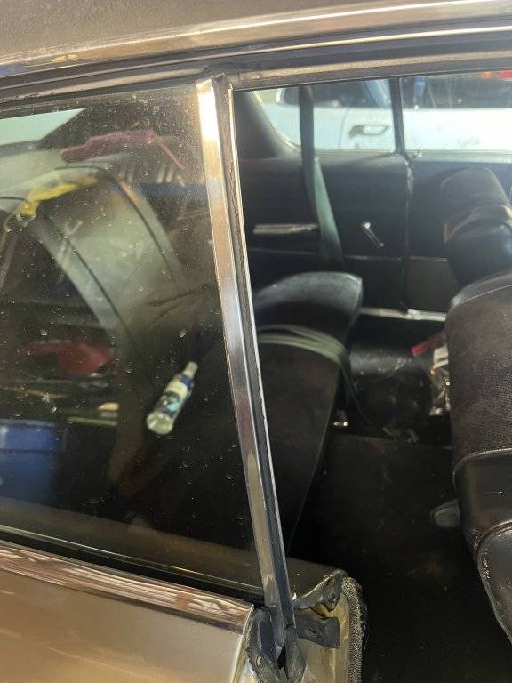

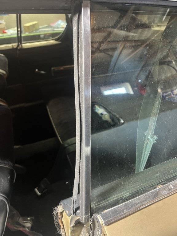

Looking for what I believe is called the rear window seal for my 68, 300. Does anyone know if these are reproduced or will I have to make my own.
Thanks!
-Josh

I just posted about this about 2 weeks ago if you want to look up the quarter window seal replacement post I made but here is probably the best seal for the leading edge between the rear quarter window and door window
1964-1969 Dodge Plymouth - Side Window Vertical Leading Edge | Steele Rubber Products
not listed for c bodies but almost an identical match to the factory ones unlike ALL the C body ones I found from the mopar restoration places like vans, mr moparts, etc
