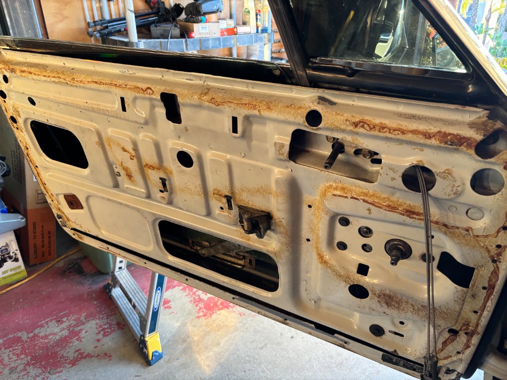

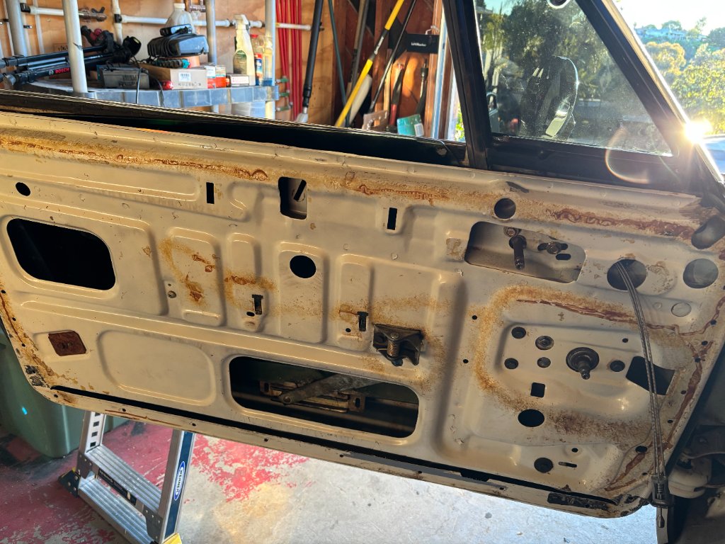

Hey thanks for that thorough reply.. I already have the interior trim panel off, along with the armrest, window cranks, etc.. what I am asking about, is then further taking the door apart, to access everything. My manual shows all the inner workings, as if interior shell is gone.. I’ll take photos this afternoon of where I’m at with it . really appreciate the response, if I hadn’t already done those steps, I would know exactly how to now! Have a great day
