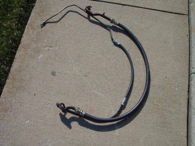

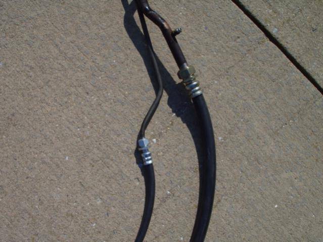

I had my A/C hoses rebuilt by Benz Hydraulics in Delaware. DSC02059.jpgDSC02060.jpgDSC02061.jpgDSC02062.jpg
I'm totally satisfied. I do have a couple of questions about mounting the hoses.

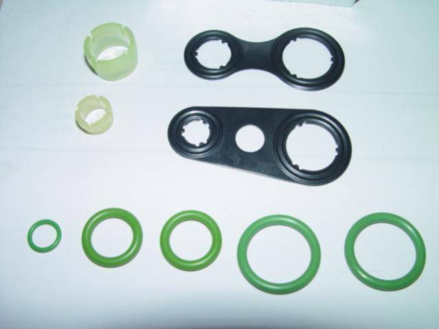

I know that the hoses ends that have compression nuts require an o-ring. The ends that bolts to both sides of the compressor and the H-Block have o-rings AND a metal gasket...correct? And the other question...does it matter which side of the metal gasket goes toward the compressor and the H-Block.
The exploded view diagram of the RV2 compressor in my FSM shows a gasket on the EPR valve side only...O ring seal on the other side.

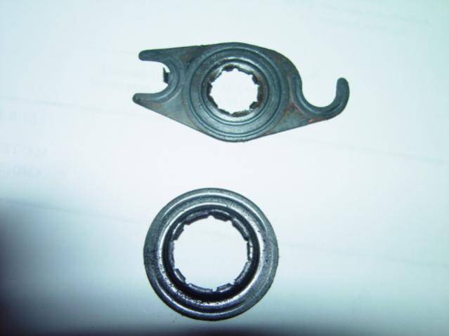

Both sides of the compressor had metal gaskets and o-rings when I took the hoses off. I heard something metallic falling when I unbolted the hose from the H-Block but couldn't find it. My question was it there a certain direction the metal gasket face because it appears to have a crush surface.
These are the old ones that came off both side of the compressor...

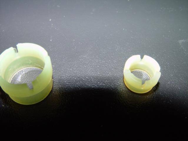

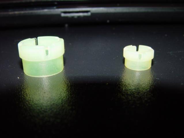

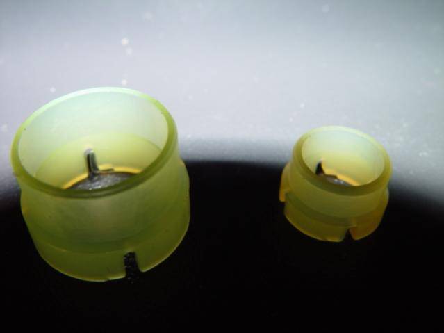

I haven't figured out what the plastic sleeves are for. It must go between the H-Block and the evaporator.
