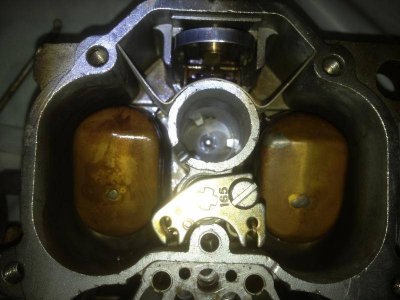

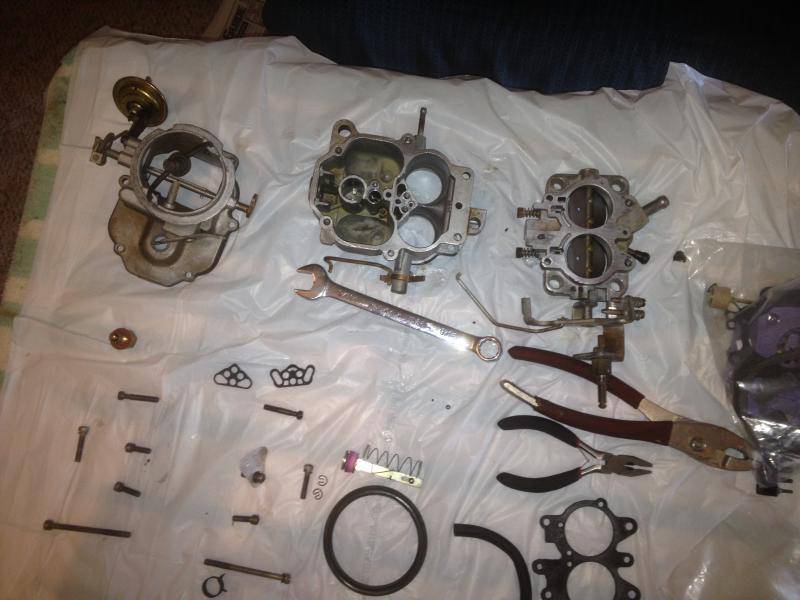

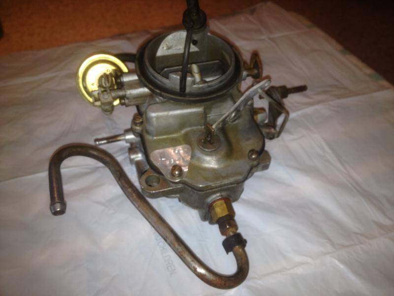

Some pics of my carb, of course none with the plunger in place.
Here is the top where the plunger sticks out:
This is with the plunger and spring removed.
All apart:

Dead center is the space for the accelerator pump and gas. That small cut out at 7 o/c is where fuel enters. So if the float is low then so is the fuel and if it barely reaches you fill hardly fill it. With a low level you will have to play with the throttle till the car gets going and the basic fuel circuit takes over. Outside of that the engine will seem to run fine except moving from 0 mph.
This makes perfect sense, thank you for explaining it clearly!
