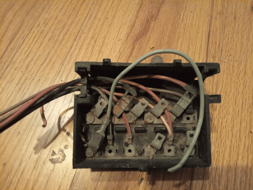

The best place to tap in for the radio is at the fuse block.
Disconnect the battery. Unbolt it from the dash, turn it upside down and there should be a spade connection for the radio/acc on the backside of the radio fuse location. Depending if that is in use for something else, you may want to use one of these "piggyback" spade connectors.
The radio/ACC fused connection would be on the lower left side in this pic I found on the intrawebs. It has the cut off green wire connected to it.
Thank you! That's ex eptiobally helpful. Hoping to be able to dig into that this weekend if I can't find time through the week.
