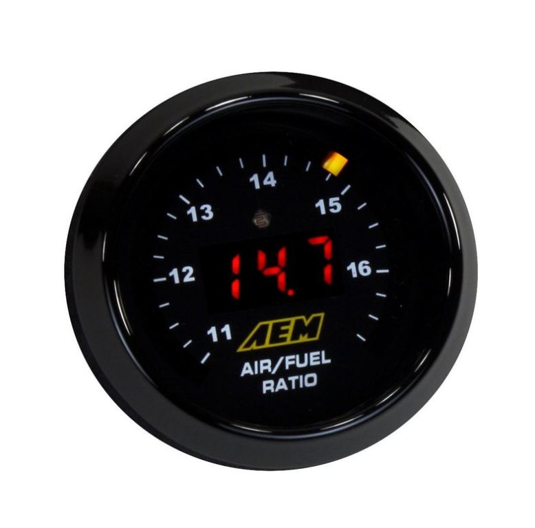

If it was me I would invest in a wide band AFR guage such as this AEM. The only way to do a proper job of this without guessing. https://www.amazon.com/AEM-30-4110-...ngads-lpcontext&ref_=fplfs&smid=ATVPDKIKX0DER

Thank you for providing example of AFR gauge, will get one.
