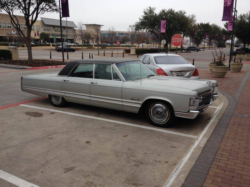

Here's the car. Her name is Sylvia. Only 80k miles. Other than the clock and the cruise, everything works. Some of you might remember that I asked the forum a couple years ago for advice on whether my brother should buy this car. Well, he bought it. He loved it but barely had a chance to drive it. So he sold it to me. I've had a chance to drive it a few times over the last year and I'm REALLY looking forward to finally having it in the same city as me (hopefully in a few months).

What a beauty of an Imperial, congrats! Nice color combo!
