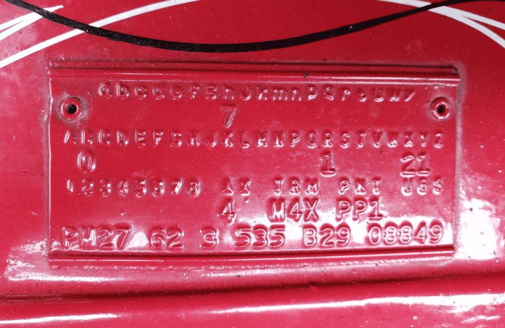

1) Is it really a 4 speed car? because they do not show the fender tag, and I don't believe I see the braces a 4 speed should have under the hood unless they are there and I don't see them.

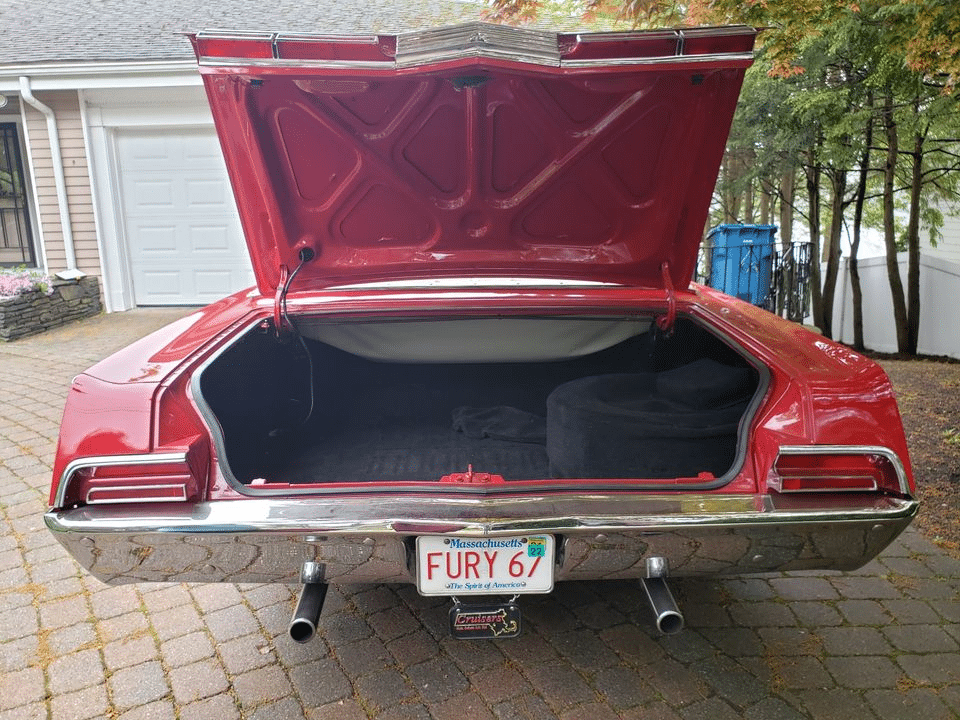

4) Why is the trunk carpet not original with a mat?

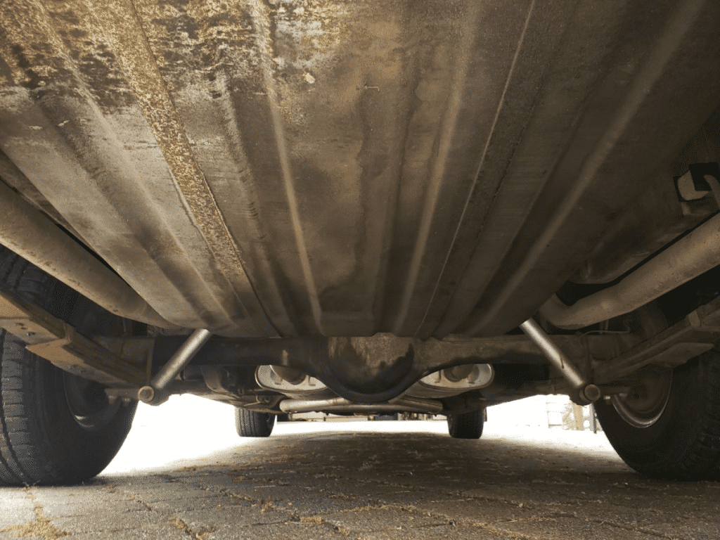

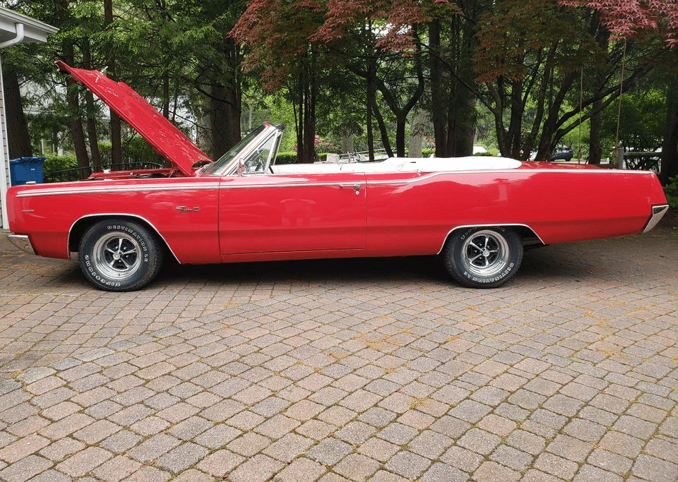

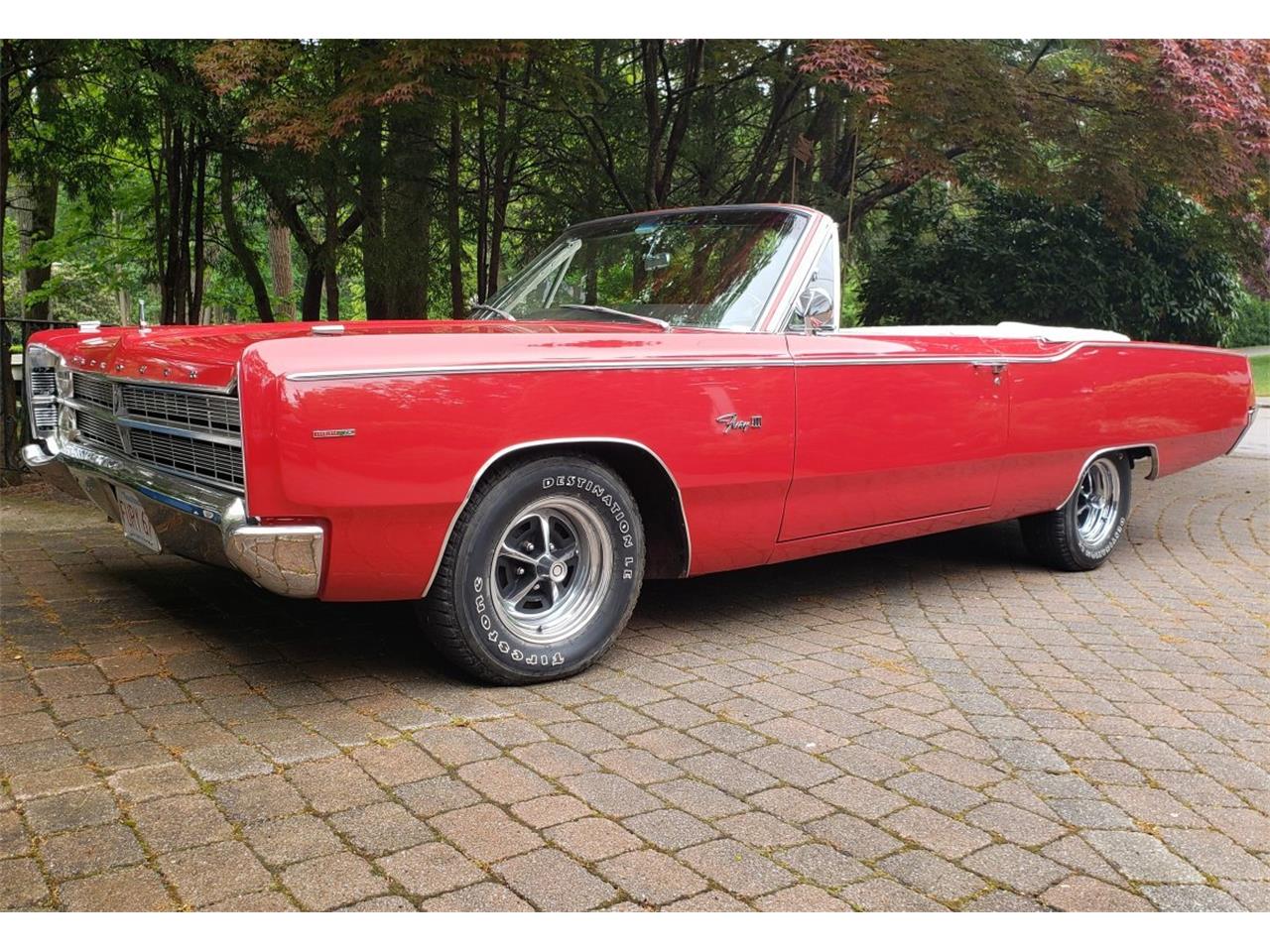

It's not really a stock resto, they changed or modified lots of stuff. It's not coded for AC & the interior should be black per the fender tag. It is an original red 383HP 4-speed car. On the plus side, the body appears straight & the shown underbody pics look nice. It annoys me that they don't elaborate on any rust areas or give close ups of the really vulnerable places like the trunk & inside of rear quarters. Most of the trim looks excellent including the impossible-to-find wheel opening mouldings. From what I see & given all the unknowns IMHO it's worth more like half the asking price, maybe a bit more.

With that said - can someone with FT expertise explain which digits are for the 4-speed? (I know the 65 FT, but not the later years).
And also - how does one verify the FT belongs to this car? It doesn't have the VIN like later FTs do.
This FT is also riveted on, weren't they all screwed-down? My 65 and my 68 are.

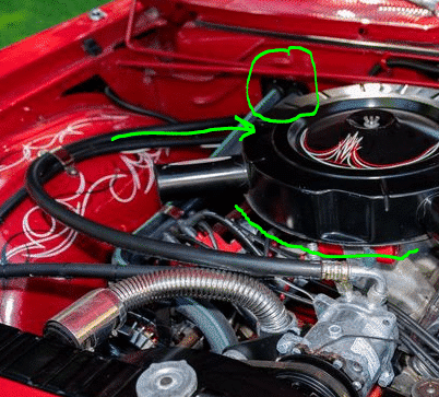

To further what @68 4spd Fury said, not an original AC car.

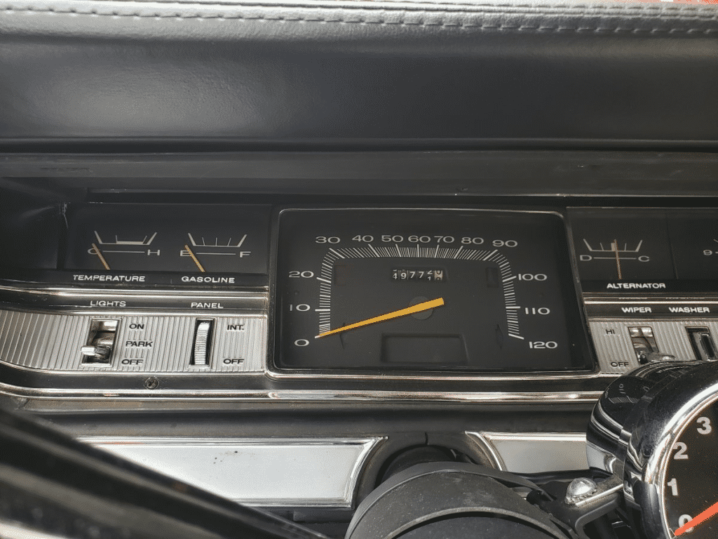

There is an aftermarket bulkhead for the heater hoses. We would also see the blower motor poking thru. Unless during the restoration they reconfigured that area of the firewall from factory AC to aftermarket, which is certainly possible, but why would you put non-AC controls and plastic IP bezel panel in the dash??? Of course @PH27L7 confirmed it's not coded for AC anyway.
Ironically, it kinda looks like it's missing the air cleaner base, presumably to use an aftermarket base and allow the original cover to hide the Holley carb, presumably it has the 5-1/8" neck. I approve of that, to allow the original air cleaner (but the pinstriping - not so much!).
Engine seems to be wearing log manifolds - is it correct that 440hp first got HP manifolds in 67, but the 383 H-code didn't get HP manifolds until 68?
As @SportFury70 mentioned - I'm not seeing the fenderwell-firewall braces, either. I don't think they are there. They could've easily been lost, or not realized for their significance of originality, though.

1) I'm still learning about FT's, but I know the number for the transmission type is the 7th digit from the left side on the very bottom line, and I'm 99% sure the number on the tag which is 3 to be correct because 5 is for an automatic.
2) Regarding the FT's being screwed down or riveted because I too thought that they were all screwed down from the factory, I asked my stepdad whose been into Fury's for 30+ years about it and he said that not all FT's were screwed down and that it all depended on the factory they were built at

#2 -Depending on the year and time of year, the Belvedere plant used rivets. Rivets are totally appropriate for this car.

The 3 definitely denotes a 4-speed. That car was built in the Belvidere assy plant where the tags were riveted. In '67 only 440HP's got the HP manifolds, not the 383's. In '68 the 383HP's got them. The top as well as the seats were originally black. The car came with manual drums but appears to have a disc conversion. The larger diameter booster likely precluded use of the firewall braces. The 4-speed hump looks a little odd but it's likely due to a misshapen carpet. Until recently there were no aftermarket 4-speed moulded carpets available so you had to wing it. They would have had to drill new holes to put in the rectangular shift boot but that's not necessary because oval boots & bezels are readily available for that shifter. Under hood it's super incorrect on many fronts but most folks don't give a crap about that anyway- at least it's clean. They did do a lot of work in changing the dash out to one with factory AC & it's a little odd they didn't go the extra yard & put in the factory control parts. You'd have to lay eyes on it to see how they rigged it up.
Thanks for all the inputs - being a legitimate 4-speed car (in spite of the mods), it will get saved into my data.
