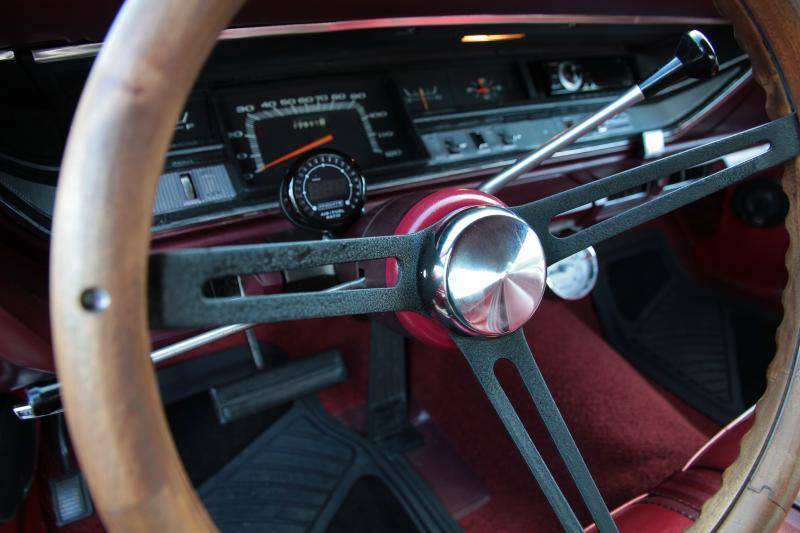

I am looking for an alternative to the red metallic paint for the dash area and steering column. I found out that it possibly is "aztec maroon poly 50755"
But I cant find a rattle can with that.... I want to paint the black Grant steering wheel adaptor to match the column. Currently tried burgundy but it looks sort of horrible...:soapbox:

You will never find that in anybody's rattle can.
Your auto body supply shop will have to do it for you from formula.
I went through this with my Chrysler.
The big issue is no one is going to be able to mix the lacquer paint from the old formula. I tried... It killed a C note for a pint of stuff that wasn't close.
If you can... take an ashtray or something similar to a well stocked auto paint store. They can analyze the color and come up with something very close in a single stage paint. From there they can either load a rattle can or better yet, go buy a cheap touch up spray gun from Harbor Fright and spray it the right way.
Hm.. okay. Thank you! I might look for something that comes close to it for now.... I sure dont like the bright Burgundy, looks very Tacky :(

Check out Rustoleum Regal Red. Its Real Close to the body color on my 69.
