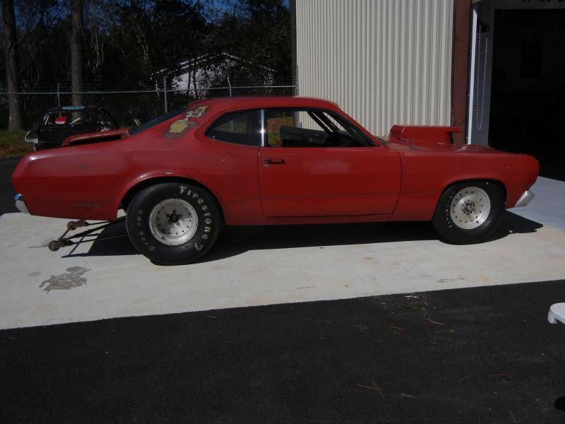

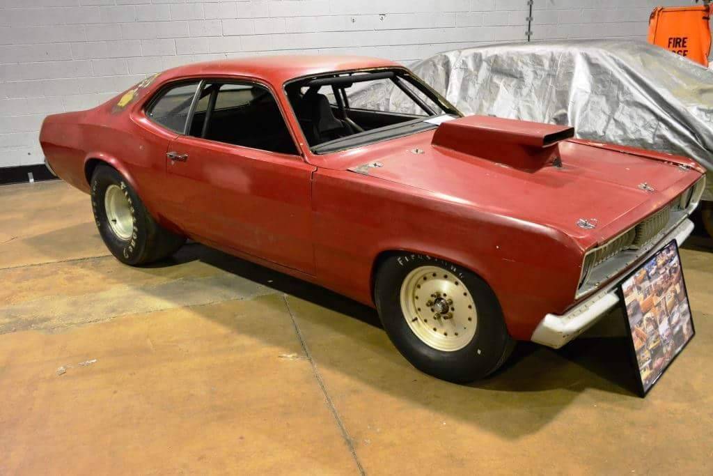

The beautifull & famous Reid Whisnant Pro Stock Duster is being restored to its original look.
Current pic
This is the only one the owner will share for now. Hopefully more will come as he progresses. I see a little wheelbase shenanigans. Can you spot it?

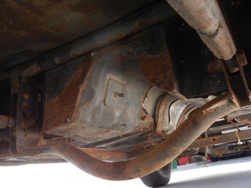

This car was built by Sox & Martin. This is the ballast bar as they installed it. Still in the car. Note the radiator hose that leads to a Pinto fuel tank I was told.
More pics
Reid mounted the rear support loop this way which was not conventional for the time. Also note the bolted in drive shaft safety loop further forward
The rear is forward in the body and it looks like the front has been stretched a bit.
