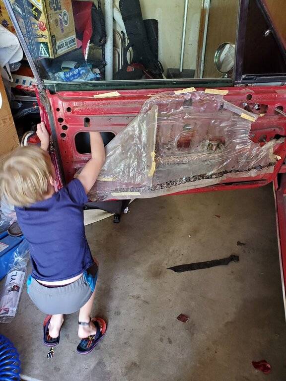

I'm taking the interior door panel off tomo to take the mirror and door handle off for a vinyl wrap job. Is it easy to take the door handle off and get it back on tightly like it is now?
I replaced the door handles on my 66 Polara not too long ago. It’s not a very difficult job. Pretty easy in my opinion. There’s 3 nuts that hold the handle to the door skin. You’ll also need to remove the clip that holds the linkage for the lock/interior handle.
I got the door handles off. Was relatively easy, just taking that whole door panel off is a pain. Here is my son helping.

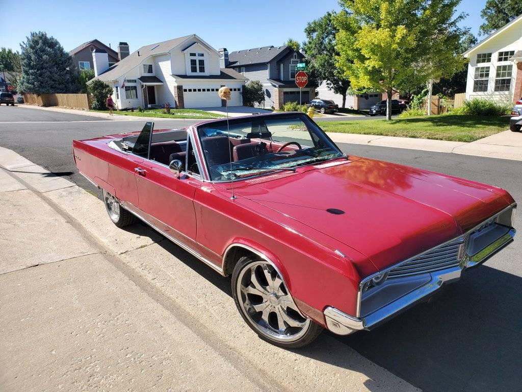

Hey there Big Red, need to do the same, out of curiosity how did the wrap job go? Did you do it yourself?
Other than a couple rookie mistakes the wrap came out surprisingly good. I did the whole thing. Was a ton of effort though. Here is a pic.
