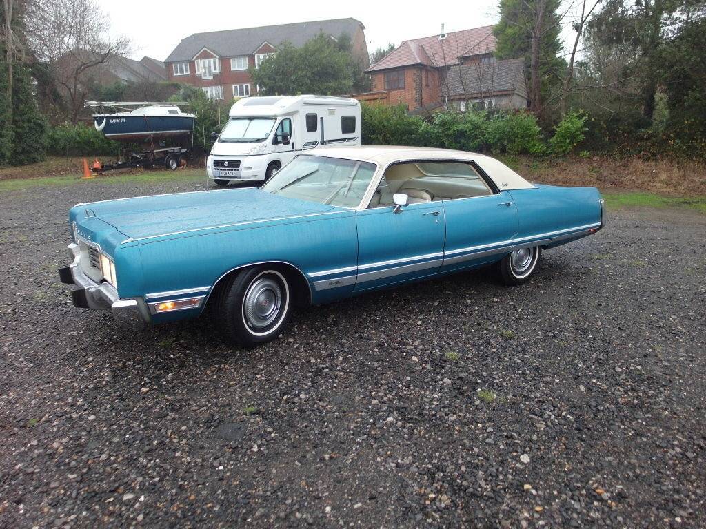

hi anyone give me any tips on removing all chrome trims on sides and top of wing,without damaging them ,for re spray.thanks Dave
Is that original? Why not leave it as is?
YES IT IS ORIGINAL ITS COME FROM CALIFORNIA AND THE PAINT IS WELL FADED A FEW CHIPS AND SCRATCHES, AND VINYL ROOF CRACKED UP,NO RUST CAR NOW IN UK
