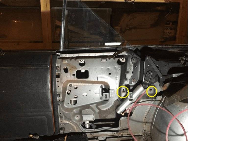

A couple pics from that thread:

I would be wary of taking things apart with the window down. Are the two bolts that attach the window to the track accessible? If not, perhaps a couple more holes are in order?
The two top bolts circled are for the track adjustment and behind the two red circles are the bottom fasteners for the track. I can get at them through the access hole, although it doesn't look easy.
Here's a view looking down at the top fasteners.
So, yes, the track could be taken out, but that would still leave the window in place, albeit loose.
I can get to the bolts that hold the glass with a swivel socket and extension, so taking just the glass out is fairly easy. Note my finger tip pointing at the glass fastener. (the warning label was on my light). I can do that and leave the track in place.
That still leaves maneuvering the regulator out. I think the pivot bracket (basically a channel one of the regulator arms ride in) has to come out, but I'm still not sure if the regulator will come out.

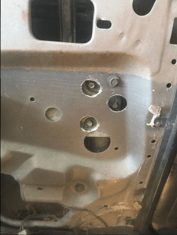

Motor is out. @413 was 100% right, the spring wasn't a factor at all.
I drilled some holes to get at the motor bolts but didn't need to for the lower bracket.

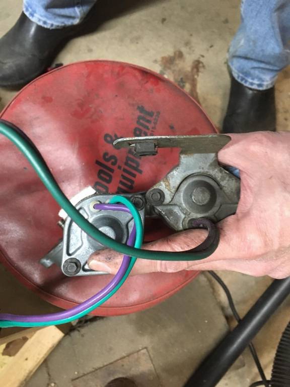

So.... Getting the new motor prepped and I hit a snag. The wire connector is different but no big deal... Just have to change the insulator.

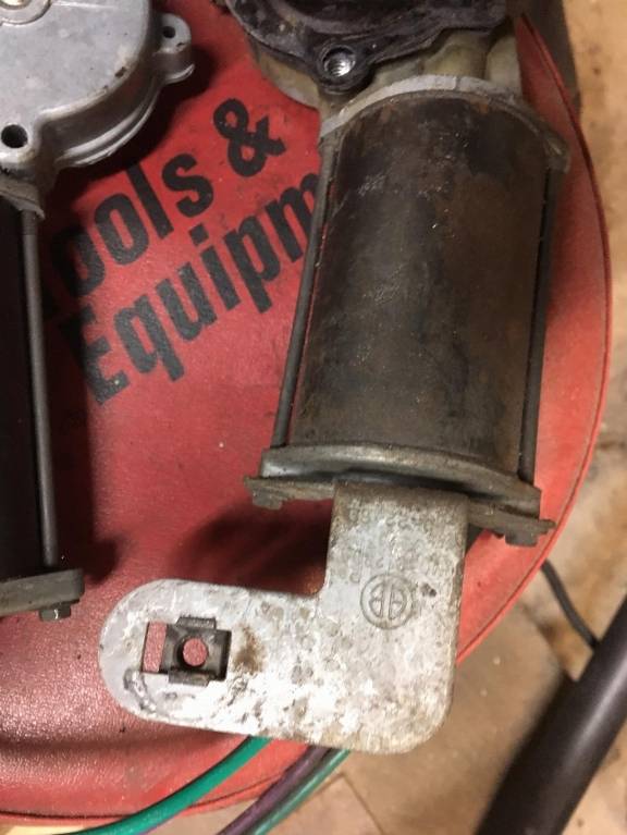

Here's the problem.... The lower bracket needs to be bolted on the bottom of the motor. Sounds easy enough until you look at the where the wire comes out of the new motor. The wires will interfere with the bracket.
I thought maybe I could turn the end of the motor, but it's keyed. I took the old one apart to figure this out and found the problem with the old motor.... A brush was stuck and there's grease and crud all over the commutator. So... I'll try fixing the old motor. If all goes well, I'll start another thread and document the repair.
