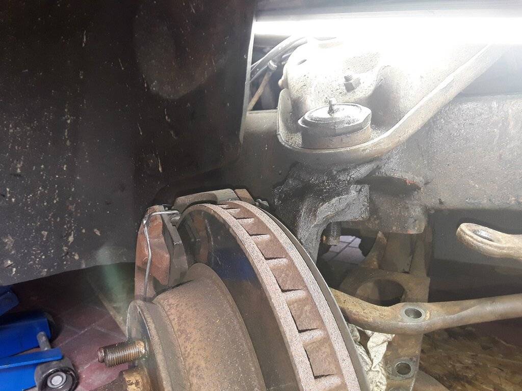

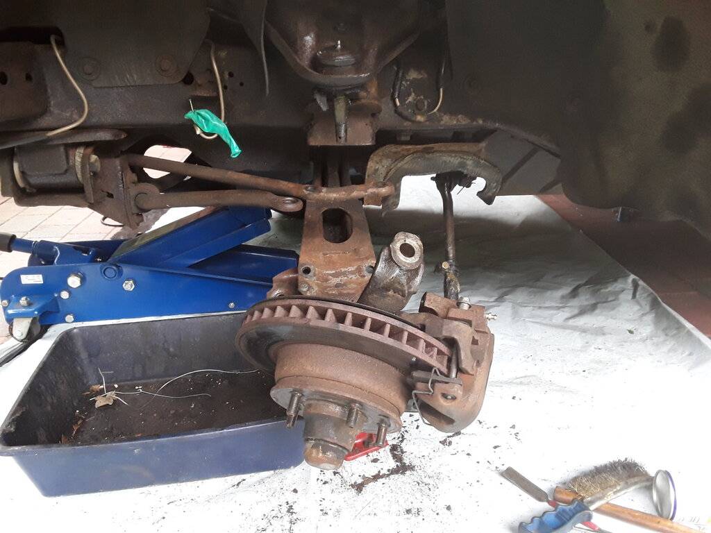

I would like to replace the shocks on my 73 Imperial. I got the old one out (cut off). But the new one does not want to go in. I have pressed it together with cable ties, but it is too tight. Track rod and lower rubber stop I have dismantled.
Now I want to loosen the upper control arm. Or does anyone have another idea?
I have loosened the lower nut, but the control arm does not move a bit. Does the upper ball joint have to be loosened?

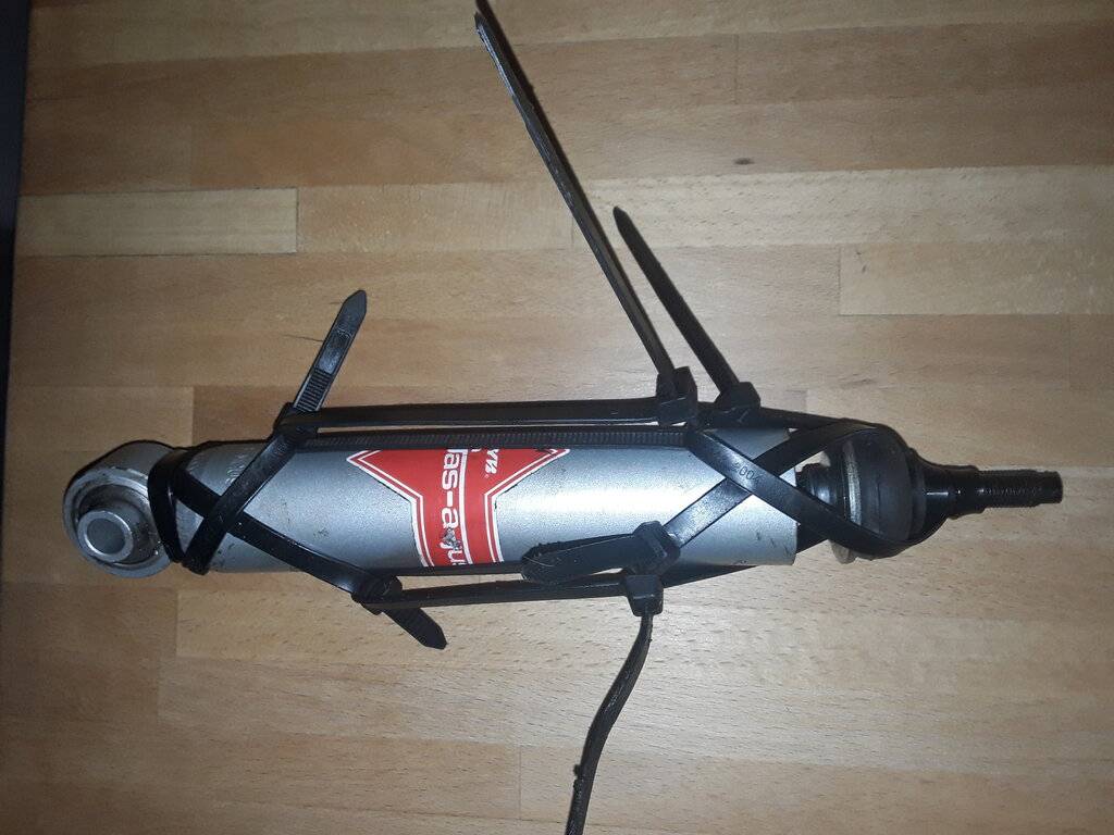

This is how far I got them compressed:
I did mine without loosening/ removing anything. Except for the old shock of course.
If it is impossible to to wiggle it in, my first guess would be that you didn't compress the schock far enough.
Completely compressed:
IF you have the lower control arm supported, then the upper bsll joint can probably be loosened. Just remember the SPRING that's attached to the lower control arm!! IT's under tension, which can cause some problems if the lower control arm is not supported and the upper control arm is loosened as it's that upper control arm bumper that limits its range of motion.
Careful!

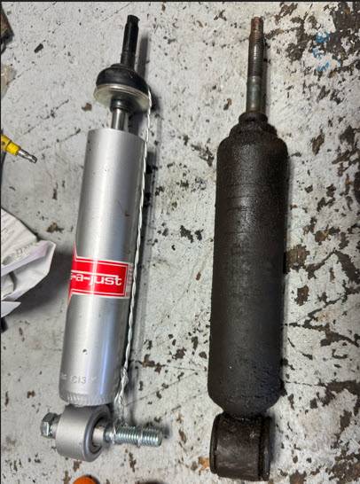

Get the other one out without destroying it, if possible. Compress that one and compare it to the new one. Are the the same length? You may not have the correct application for your ride, i.e. To big a shock. Good Luck
Last time I went through this, I noticed the new shocks were larger in diameter than the originals...made it a pain.
The stock shocks should have a 1" piston, which also relates to their outer case diameter. Which means the HD version of the stock shocks would have stiffer valving in them, rather than the larger piston that is normally in HD shocks, then or now.
How do the case diameters compare between the ones removed and the new shocks you have? Just curious.

Mind you I've only done the front shocks on my 68 NYer. They have to go up through a "tube" I'd never be able to get all of those ties cut off. I used one large tie (24") and two smaller ones (6"). The smaller ones I used to attach the large one just under the washer on top and then wrapped the larger one all the way down around the eye on the bottom.
God blessed me in that just as I had them nearly in position the two smaller ties broke and released the large one.
I was able to compress the old one without any problems. But he did not go out, so I cut him off. The length of the old and the new are identical. The new one is even a bit thinner.

I have found the cause. Some time ago I lowered the car with the torsion bars. Yes, I know. You shouldn't. But I did it and I like it.
This has reduced the distance between upper and lower control arm by a few mm.
Since I had the upper joint ball off now , I took the opportunity to change the balloon seal.

I just did the front shocks in My Buddies 1968 Imperial, yesterday without having to remove anything but the shock so the process is very fresh in my mind. I've gotten so much help from this site I wanted to share. In my case the old shocks were so bad that once the nut was off the stem they collapsed - so no worries about compressing them to remove. I'm sure folks will tell me I did it wrong but I got the shock toward the back and it was so close - it looked like I needed about 1/4 - 1/2 inch more clearance - since they were the old ones I tapped on them with punch and hammer and they popped out with little effort. That went so easy when I installed the new ones (fully collapsed) I reversed the process and got them close and then tapped them the rest of the way in - I said tapped not full blown hammering! (The the rounded end provides a sloped surface and the shock appears to compress slightly to get the added space required) The shock was not harmed. Getting the new shocks compressed was a challenge I used my bearing press and wire. When you cut them lose in the car make sure you have a pry bar/screw driver under the shock so you can move it to make the bolt alignment and install easier.
