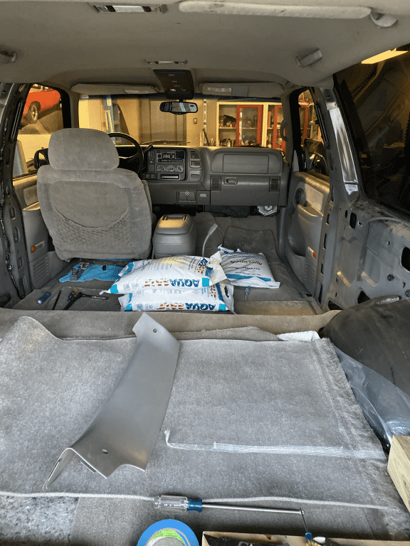

I had changed the carpet on my Tahoe. I had kept the original carpet. Test fitted the new carpet and found all the saggy parts that didn’t have the large pieces of backing. Took the original pieces off the old carpet test fitted before gluing to the new carpet. Now it’s firm and tight. The original backing I’d 3-4 times thicker.
Test fit for front. Put 40lb bags of salt on top to mold it on a hot day.

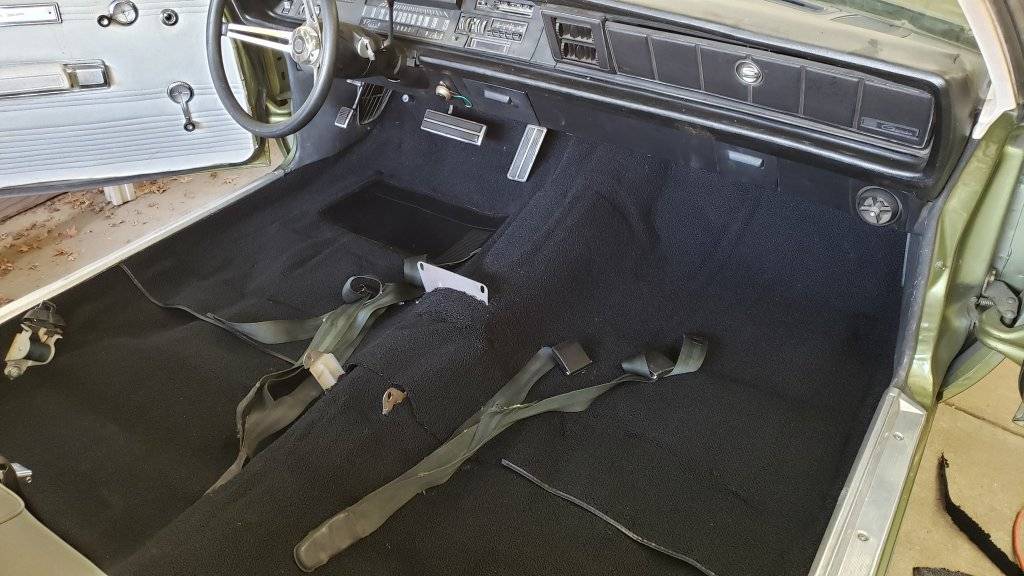

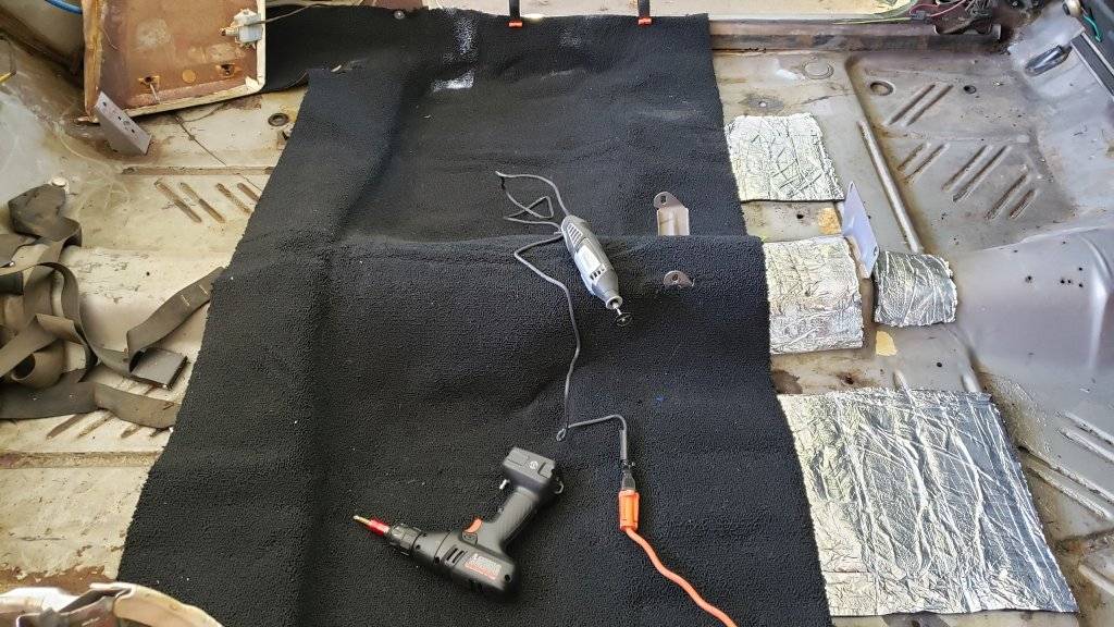

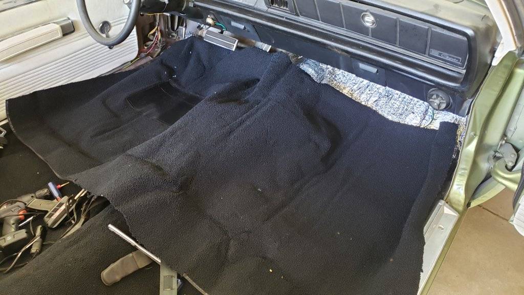

I got a real nice carpet kit for my '70 Newport from Legendary Auto Interiors. I bought self-adhesive padding through Amazon. Both worked great.
I'm at my main computer, so I can post a few shots!
Went from the back forward. Big John suggested using a soldering gun to punch the holes through the carpet and pad; it worked great!

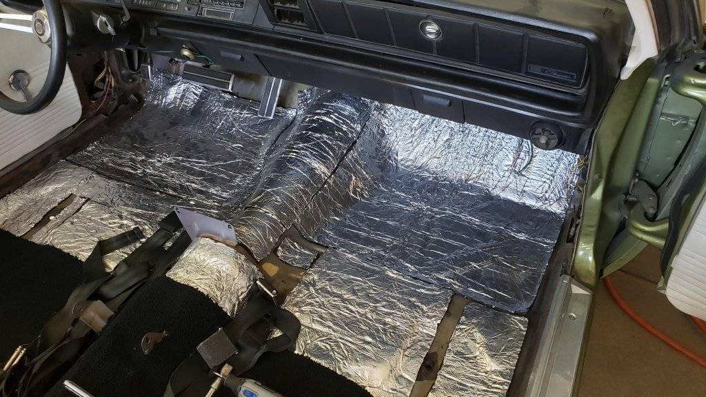

This was the padding I bought through Amazon. Easy to use and worked great. There are "better" ones out there, but I am certainly not complaining. Kit comes with a roller too.
