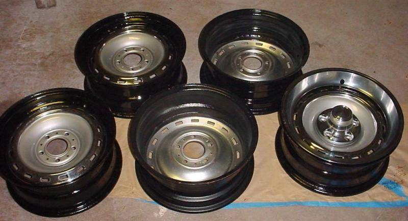

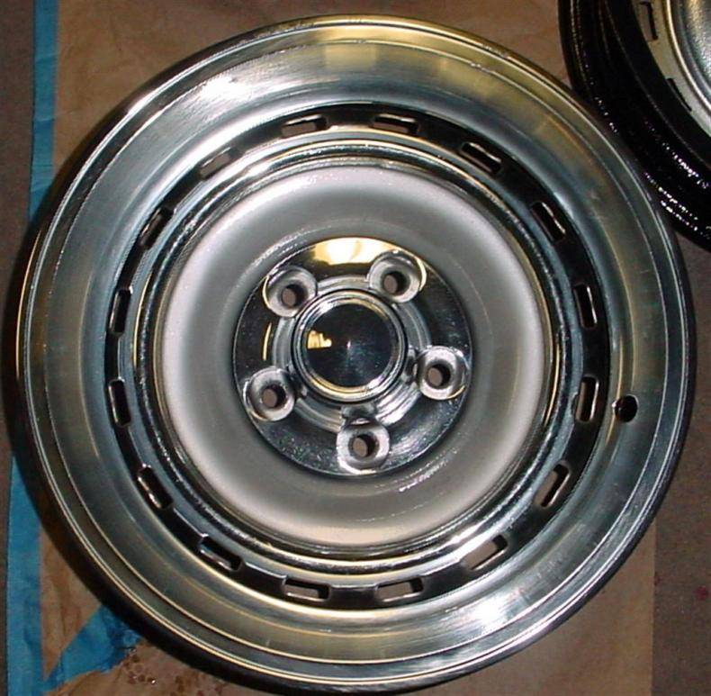

I redid mine last november..... Blasted the rims, polished the chrome, Masked and painted the rims gloss black, masked and painted the centers silver metallic and then clear coated everything.
Their holding up well and easy to clean .
